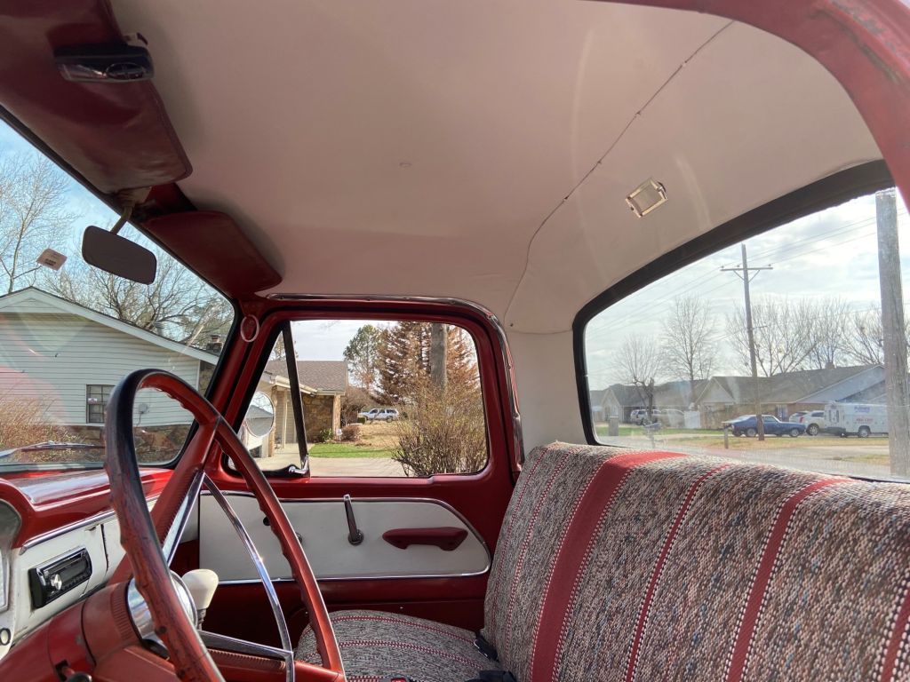

I used the same thing to make mine with the smooth side out. I will be covering it to give it a finished look, but yes it works well. I used carboard and tape to make templates from the roof inside the truck. She ain't perfect, but it does the job for now.

This what the FRP looks like once it is covered with vinyl. The clips for the headliner came from eBay (LMC or Carpenters).
