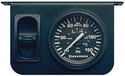

Ive got my Viair installed and the Firestone Ride rites are on their way, What Im looking for is something to control the airbags other than
this..
Is there a remote option that wont have wires or tubing running into the cab? Kind of like the Air lift wireless but without the onboard compresser since I have the Viair.
Thanks everyone!!

You can use the AirLift kit. Just get a kit without a compressor and in the circuit replace the "compressor" with a "solenoid".
I use a 1/4" air horn solenoid to control my air bags for my hitch with the AirLift wireless.

Checkout AccuAir - Air Suspension
Their valve control system for air suspension is great!

This would work as Porthole described. Here is a link to the install manual which shows the schematic for how everything is plumbed. Might make a little more sense after looking at the schematic.
Also, for custom ordering a kit without something like the compressor I typically suggest giving Michigan Truck Spring a call at 1-800-358-4751.
Another route you could consider going is using auxillary outputs on an aftermarket alarm to trigger a supply and dump valve. This gets quite a bit more complicated with wiring and potentially diodes. If you have an aftermarket alarm and would want to go this route shoot me a PM and I could put something together explaining it better.
