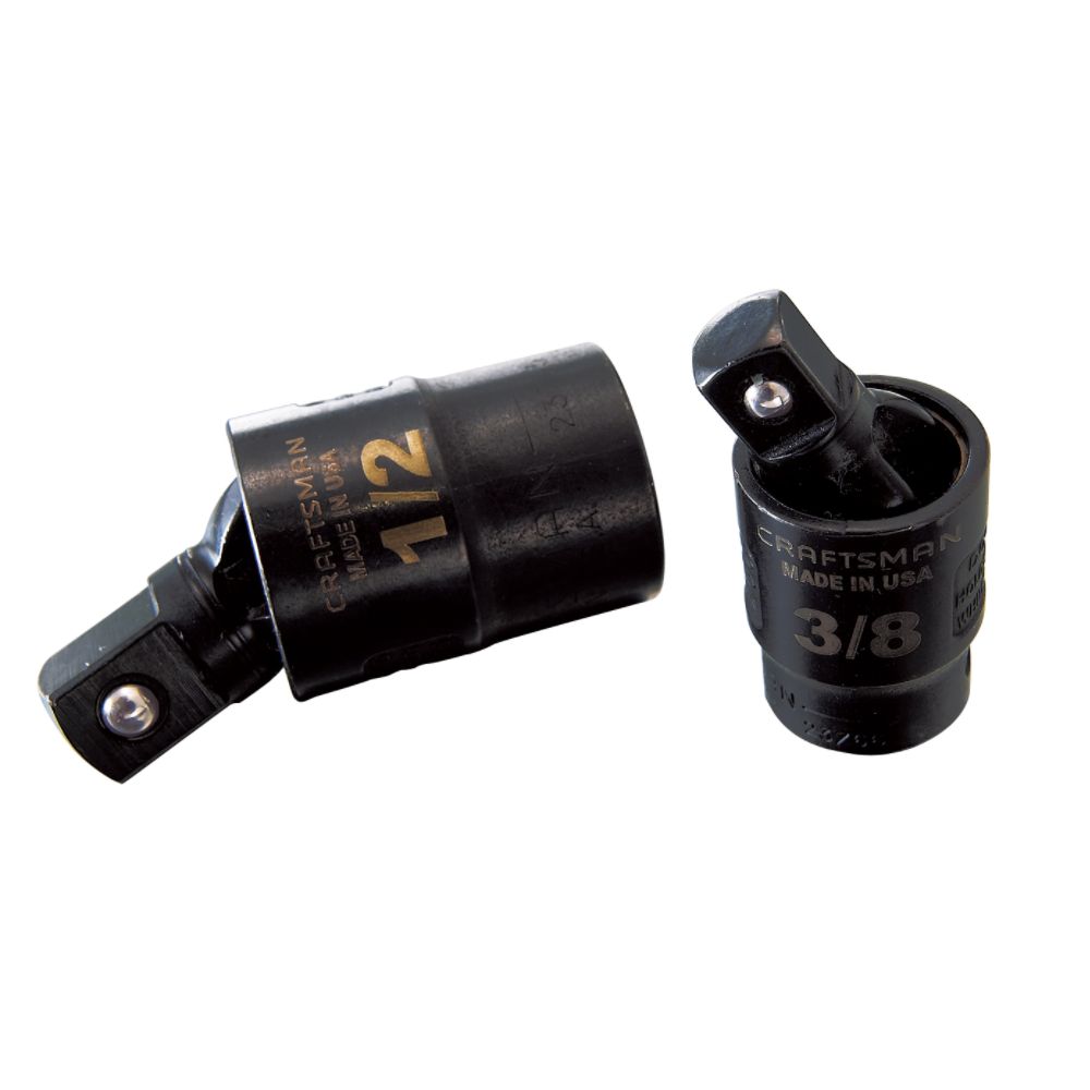

Old Aug 9, 2012 | 12:05 PM

Not feel'n it Lloyd...Whats the pic suppose to mean?

Could you get at the bolt with an impact, swivel, and socket?

The crank pulley bolt everyone is talking about. lol

LOL....i believe you CAN get to it, but i lucked out. Was able to use a breaker bar, put 6spd in gear, chaulk the wheels, and turn. Snapped ur right off. IF/I have small impact sockets, then YES, i there was enough room for my 1/2in impact, to back-up enough, with fan/shroud removed. Only to i'd say, 1 complete turn, then the rest of bolt could be removed by hand.
I think the h/b sits perfect in a location, that it would bind up ANY/ALL swivel/wobbly sockets, you through at it.
