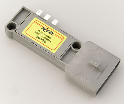

I ordered an Accel 35368 TFI Module...
My issue is that it is oriented backwards compared to my truck. My current TFI module mounts to the passenger side of the dizzy and points towards the front driver side of the engine bay for the connector.
The new Accel module if mounted would point to back of engine passenger side for connector.
I checked my 1996 Eddie Bauer Bronco 351W automatic 4x4 and it has the remote mounted TFI on fender, but still has same orientation as mine.
Every website, manual, reference material I find states this is the correct Accel Module.
Can someone help me with this puzzle? Now that I'm out the money..
Thanks

The one that goes on it and points to the drivers side is the one in the image below.
