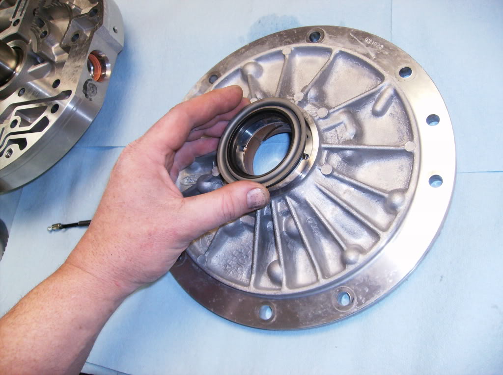

Here is a picture of the bushing installed, and staked, the right way.
Name:  4R100 Pump Bushing and Seal.jpg
Here is a picture taken from my Ford manual. Open end of groove on gear set side of pump.
Attachment 57634
Attachment 57633
Thank you Roland !! Nice find on the Ford Manual and on the photo of it being installed correctly. Thanks Brother
