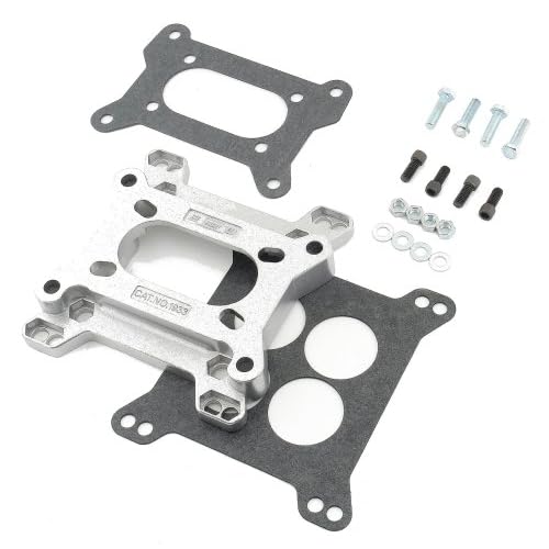

Just wondering if the design of the c intake will allow for a 2 bbl carb

Completely. All you need is this:
Amazon.com: Mr. Gasket 1933 2-Barrel to 4-Barrel Carburetor Adapter Kit: Automotive

I was lookin at o reillys for this..I just thought since the c intake is an open openings style then the 4 holed gasket wouldn't work

I missed that it came with a 4 holed gasket. I wonder why? Either way, the plate is what I was mostly referring to. You'd need one of these to go onto the Offy C (whether you use this or a 4bbl):

Ok so ill just get the adapter with a separate gasket. Now I need to get the cfms on that carburetor
