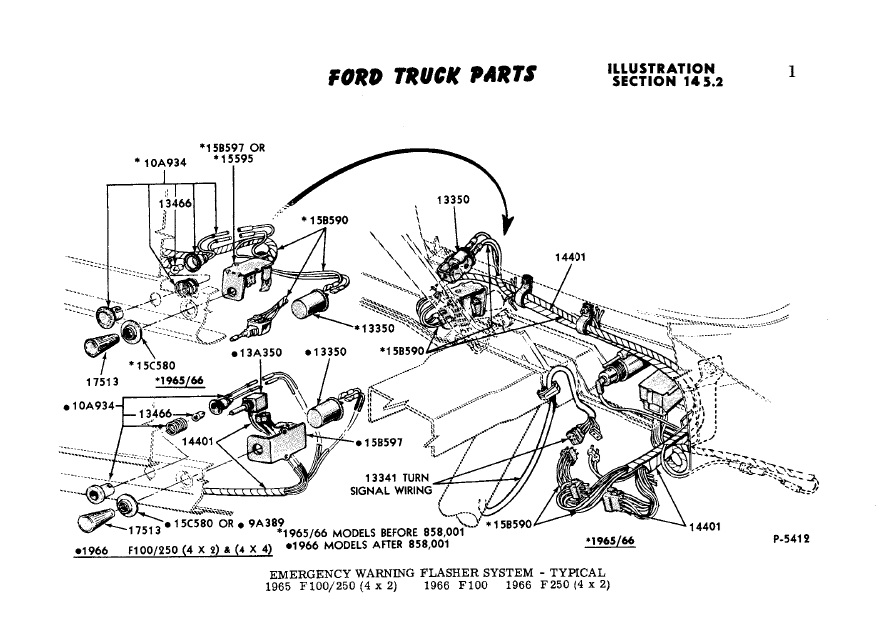

Here's the 'typical' drawing from the MPC. 1965 and 1966 through to end of April upper left and right. May 1966 onward in the lower left. The bracket holds the switch and the flasher 13350.
