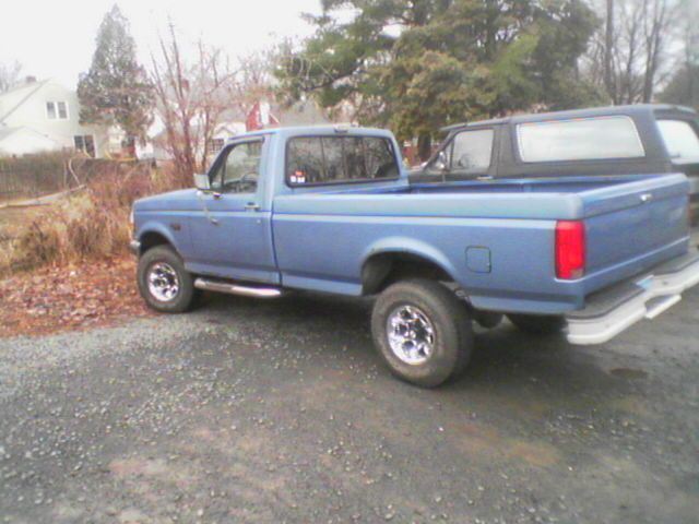

I bought him March '07 and he was in dire need of rescuing. He is a '92 F150 Custom and his only options are 4wd and sliding rear glass. Truly a bare bones truck, almost surprising that he wasn't painted white.
He didn't run right (only ran w/ the MAP disconnected) and had some frame rot (the bumper was hanging on by one side only) but he had 4wd and the price was right $500. He had high mileage (220k) but I wasn't afraid, his heart is the old 300 which can go much further.
So I got him back to the shop and attempted to pull the codes, only to find the his brain was toast. $125 later he was running like a top!
He had no radio or speakers and tires with a fair amount of dry rot. After a call to Crutchfield, radio was on order and I found a set of used 31" x 10.50 Goodyear's on Craigslist for $225 that were like new. I had some stainless tube steps ($150) and American Racing wheels ($260) I scored off Ebay in my basement for the Bronco but ended up going on him.

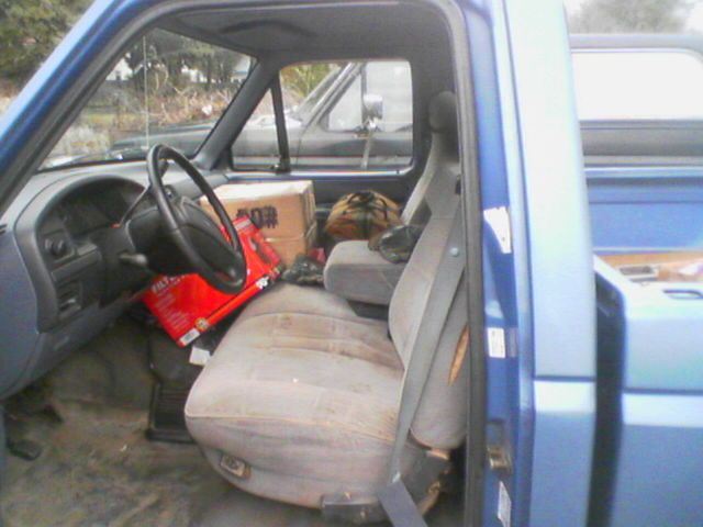

His vinyl bench Had to go, so I found a cloth bench w/ the fold down arm rest out of a '95 xlt at a local boneyard for $60.
And that was how I had intended to leave him even though the rear bumper bounced as I drove down the road. Only to find out after filling him with a nice meal he had a half tank by morning, he had severe stomach cancer. So I decided to pull the bed off to fix the frame rot and replace his fuel tank at the same time.

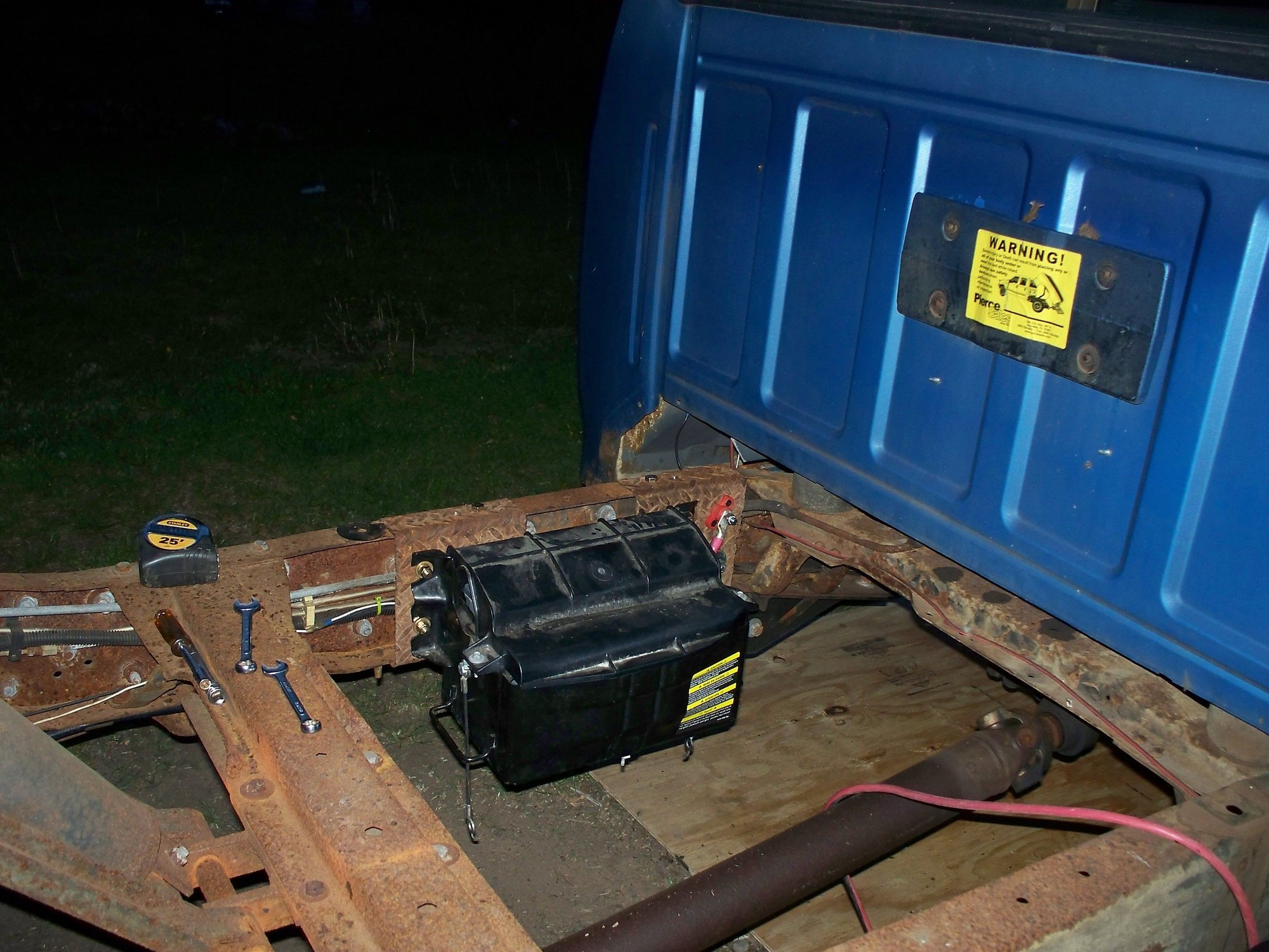

I pulled the bed at home and made some homemade mudflaps and drove it to work to fix it there.
After pulling the bed I found the rust to be more severe than I thought so I had a boneyard we deal with back half a good truck so I could section the frame rail. I also swapped two of the crossmembers w/ the frame I got. I initially thought the frame was just bad at the rear hanger and it was only after I was finishing the section that I found the front hanger area was just as bad. So there are three weld seams, the shiny diagonal was going to be the only one. I didn't have enough frame section left to do diagonals for the other two so I took the opposite side and cut the top and bottom off of the C channel and nested it into the sectioned frame for additional strength and bolted it together with grade 8 9/16" bolts
I had a new fuel tank for the Bronco already, so I decided to use that instead of buying a new one. Since this is a single tank truck this also adds 14 extra gal. at the same time.
