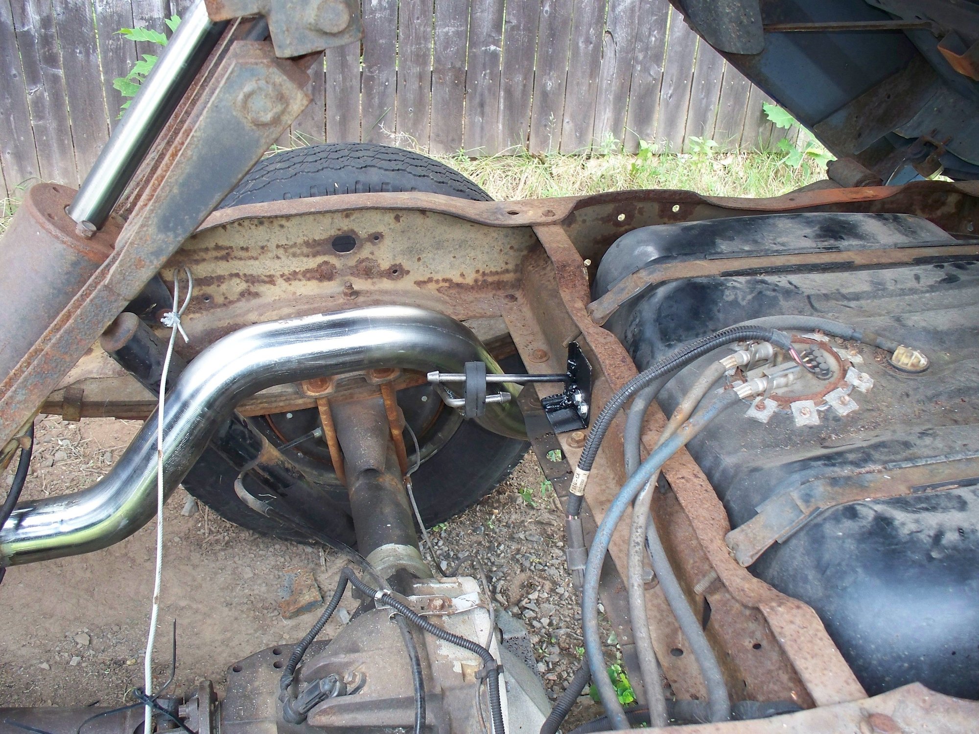

I put the bed down and measured and saw that it was 9" too low. Way too much to let it slide so I decided to raise it up.
these are pics of how high it is now and the rear hanger
That took most of Thursday, really didn't think it would take that long but it's my vacation and it was too hot so I was dragging a$$

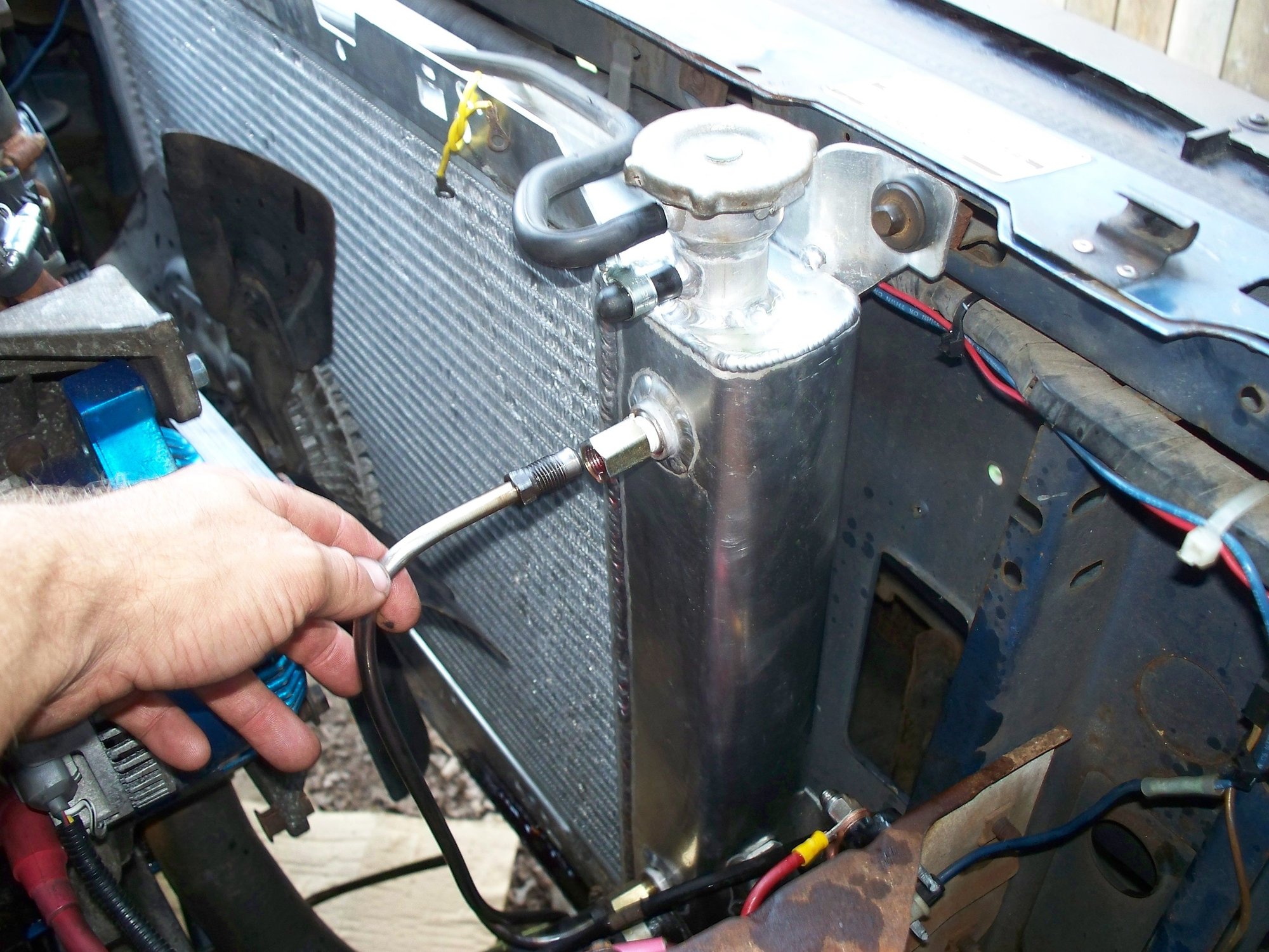

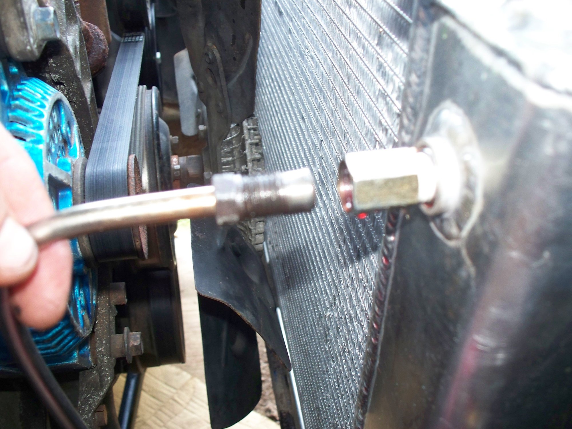

Friday I bent up the tranny lines, what a pain in the butt that was. I used stainless 5/16 line, wow that stuff is a bear to bend. Ended up using the torch to heat it red then bend slowly so it wouldn't kink, had to use the torch to flare it as well. Radiator is in although I didn't hook up the heater core yet (I think I want to do something custom while running those hoses)so I just put on U hose to close the loop. Noticed the thermostat housing is leaking gonna have to put a new gasket in there but I'll wait to see if I want a different temp t-stat to get the tune right. Finished the battery cables and ran a new negative as well (didn't think I was going to need one but using the frame wasn't cutting it) fortunately I still had enough left over 1/0 cable. It's red but I put a few spots of black electrical tape along it to mark it as a ground. After running the new ground cable it fired right up.
I started filling the tranny and the line going to the radiator is leaking (damn) so I tried tightening it and the fitting cracked and the leak got worse (F'n Damn!).
Local parts stores don't carry these fittings anybody tackled trans lines before?
It seems that most people change out this fitting for a compression fitting but of course the hardware store near me only has a 1/4",3/8", and 1/2" not the 5/16" I need, wonderful. I did find it on the web so it's on order.

justin did you make the trans line? did you double flare it? i could grab my double flare kit from home and lend it to you if you need. a single flare will never seal, learned that in high school when i though i knew how to work on stuff.

Ya, I double flared it with my snap-off kit. Most reports I read say the trans line pressure is low, 30-35psi or so, and that a compression fitting should suffice and a single would be fine. Since I cracked the fitting over tightening it and now can't find them anywhere, so I ordered a compression 5/16" to 1/4" NPT fitting online.

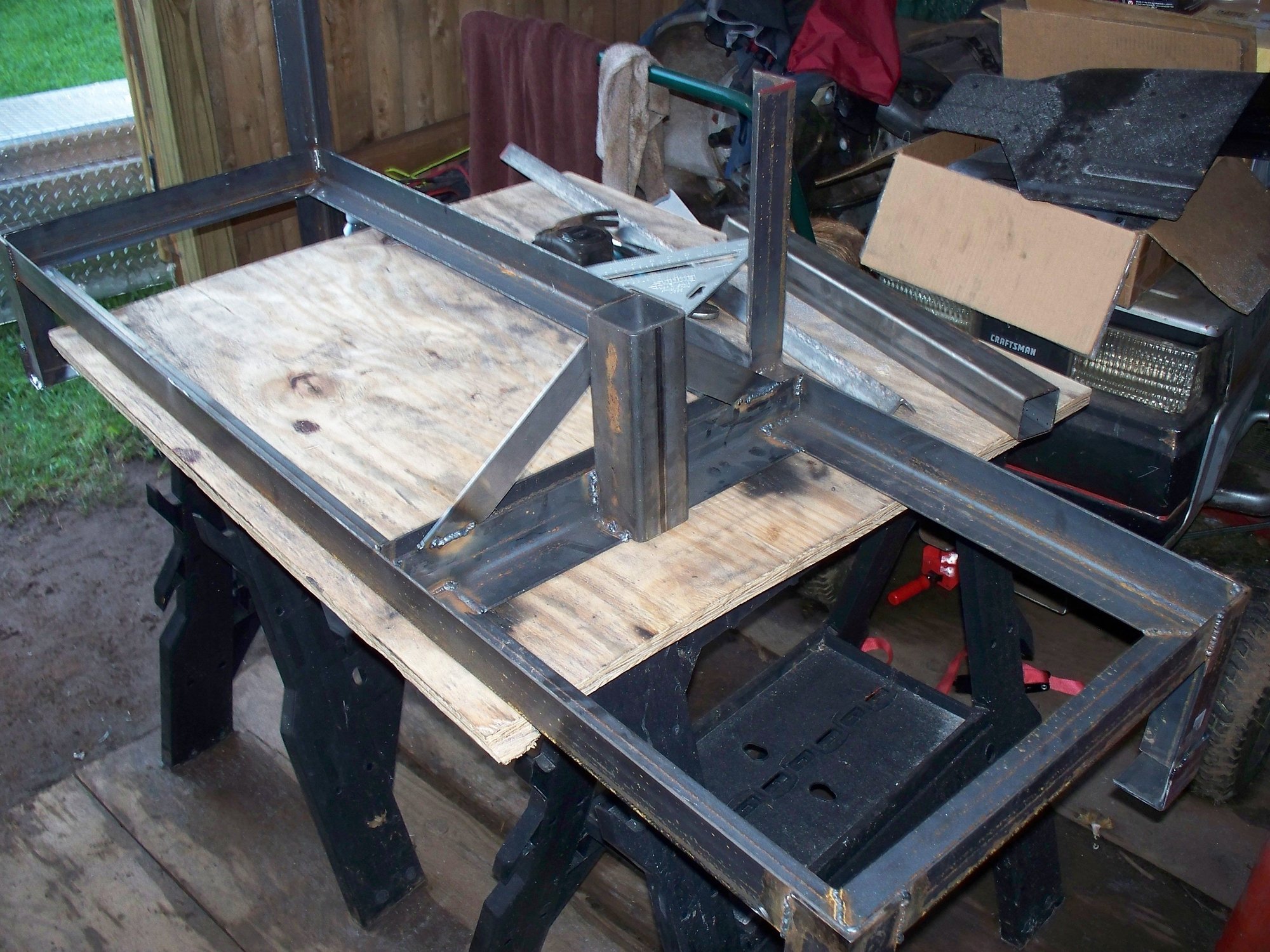

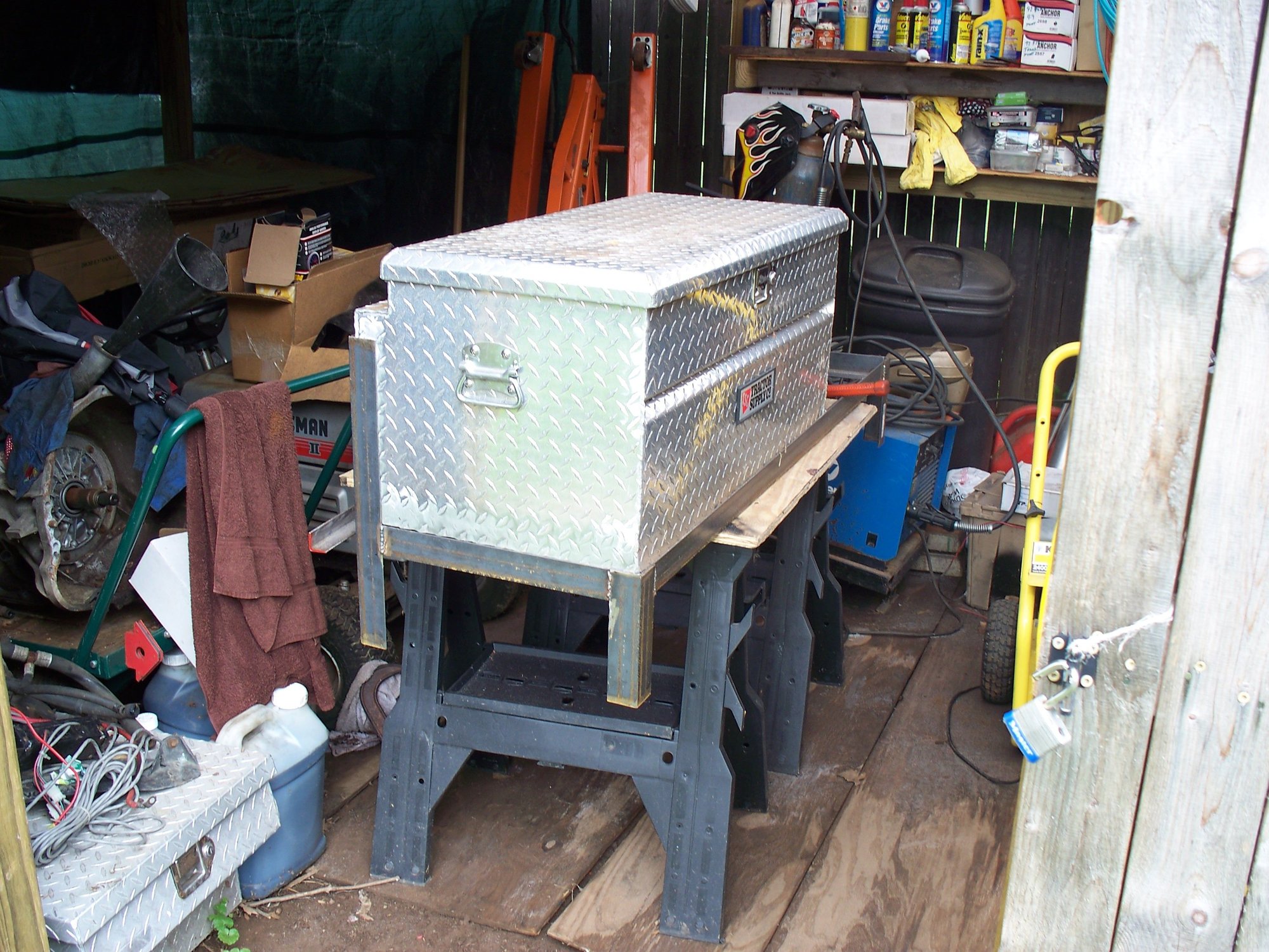

So since I'm still waiting on that part I've been working on a mount for the tool box and spare tire
