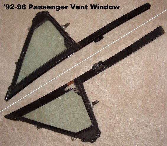

The VIN isn't ON the dash...It's on a metal tag, that's riveted to the cab...
The dash'es WILL interchange....
The only things different is:
The vent windows...The 1990 windows will hit the 1993 dash upon opening them....That's why the 1990 has a full triangle of a window, and the 1992+ models has the lower corner cut off....
And the Steering Column is a tad different between the 2 year models...Not really sure if that will affect the 1993 dash.....I wouldn't think so at least....
Here's the 92-96 vent windows, with the 1990 style dash..

So I can swap the dash and I could swap over the side window frames from 93 doors?
Old Apr 28, 2012 | 12:09 PM
SideWinder4.9l's Avatar
SideWinder4.9l
Joined: May 2009
Posts: 8,843
Likes: 27
From: Eastern Ky
If you're using the 1987-1991 style dash the windows aren't a concern...
It's when you try to use a 1992-1996 dash, with 1987-1991 windows....
The 1992+ dash is thicker from front to back..
