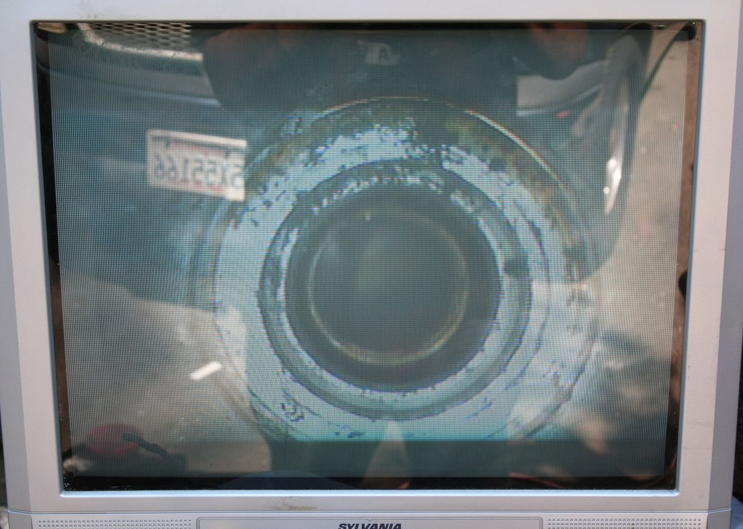

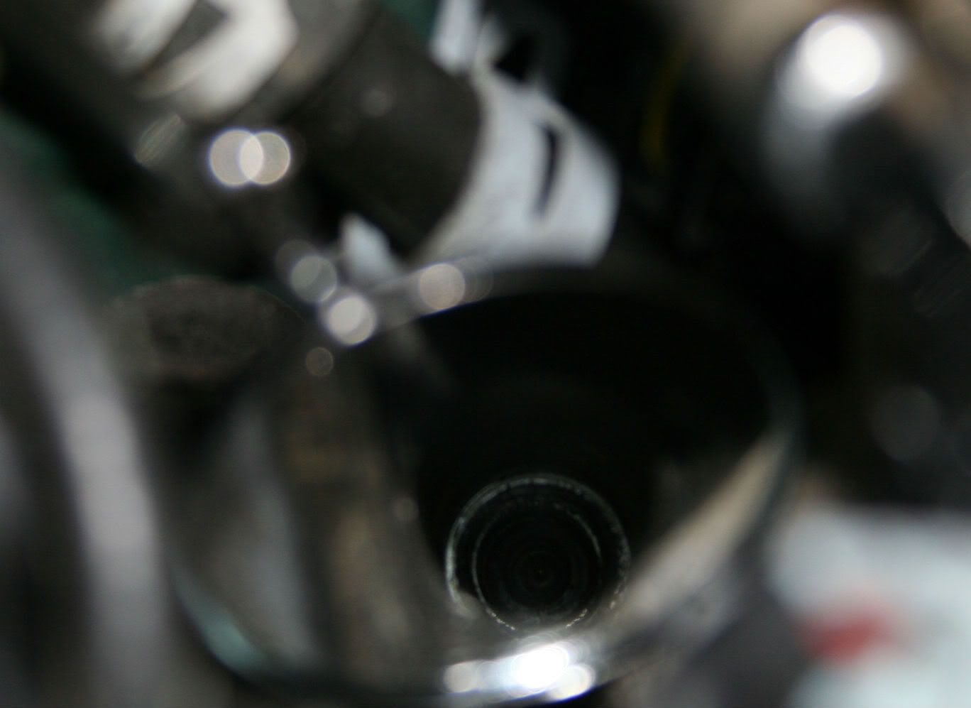

OK, i got an inspection camera, and stuck it down there. First image is of the front plug, passengers side, with which i have no problems removing and installing a plug. The second image is of the one i am having issues with. It would seem that there is definitely something in there still, but what? I pulled a complete plug outta there, in one piece.
It's almost like someone previously broke a plug (or?) off there, and then somehow managed to screw another plug in on top of it. But if that were the case, i would have expected a misfire at least. I don't get it at all. I get the feeling the head is going to have to come off. &(&# it.

Thankfully, crisis averted. I put the 7th plug back in, and fired it up. Something went POP. Shut it down, stuck the camera back in the rear pot, and waddayaknow, hole now clear. Screwed in the new plug, and away she went. Thank fvck for that. I guess something must have fallen in there after removing the plug. Haven't been able to find what it shot outta there, just thankful it did!
