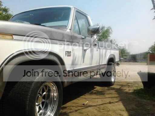

I Am Pedro, I Drive a 1986 Ford f-150.
I Wanted to Know If It Would Work if i remove my stock ignition coil And Put accel super stock coil 8140. Do You all think it would Work Different.
Any Comment Welcome.
This Is My Truck

That's a fine truck, Pedro!

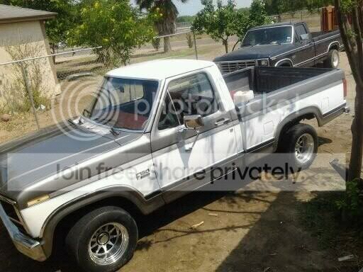

81ChopTop Pretty Nice Truck the 81 flareside
I Got One Too But Mine is an 82. I Just Need To Fix it.
Old Apr 15, 2012 | 11:00 AM
81ChopTop's Avatar
81ChopTop
Joined: Nov 2011
Posts: 1,033
Likes: 11
From: Wausau, WI
Thanks man. You should put up a few more pics of yours.

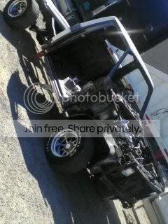

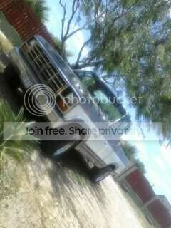

Of This One Or The Flareside
Old Apr 15, 2012 | 11:10 AM
Ford_86's Avatar
Ford_86
Joined: Apr 2012
Posts: 19
Few More Pics
And When i Rebuild it

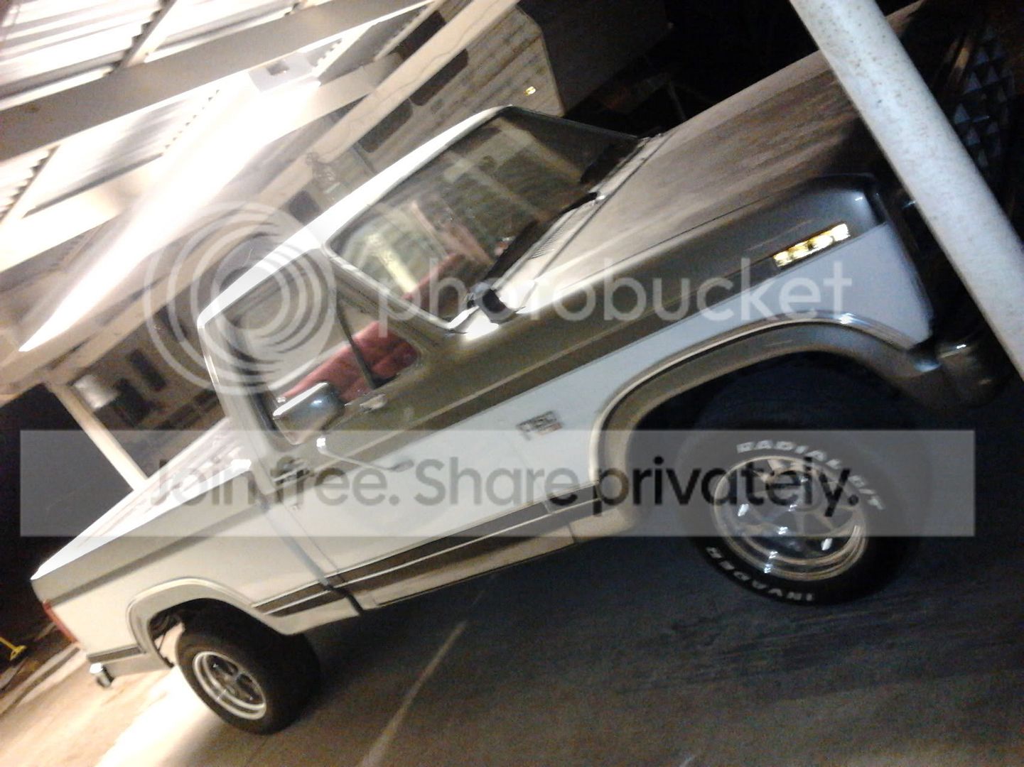

Diggin' the paint scheme and colors. The wheels look great on it too.
