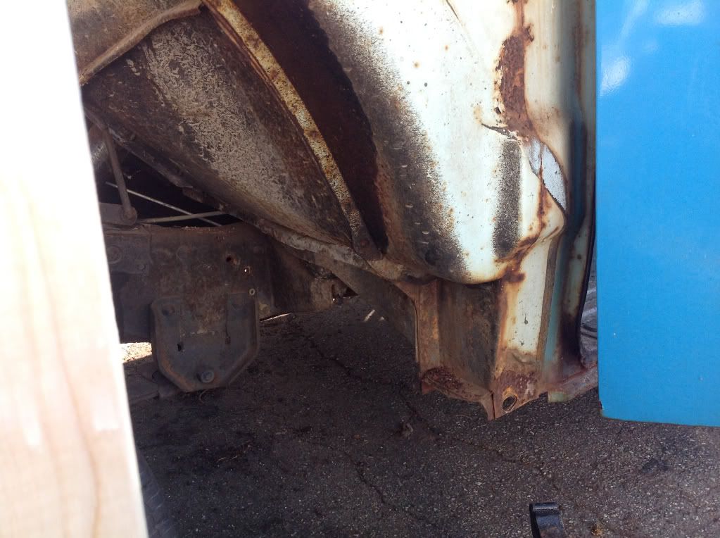

did some more digging and cleaning and found some more rust holes (hidden where the cab mounts mount to the cab. the mounts seem solid, just the part of the cab that holds them is bad. ugh

You will probably find more holes if you take the front fenders off. The cab wall that makes the outer end of the cab mount holds water from the cowl vents. There are drains but they always plug up.
