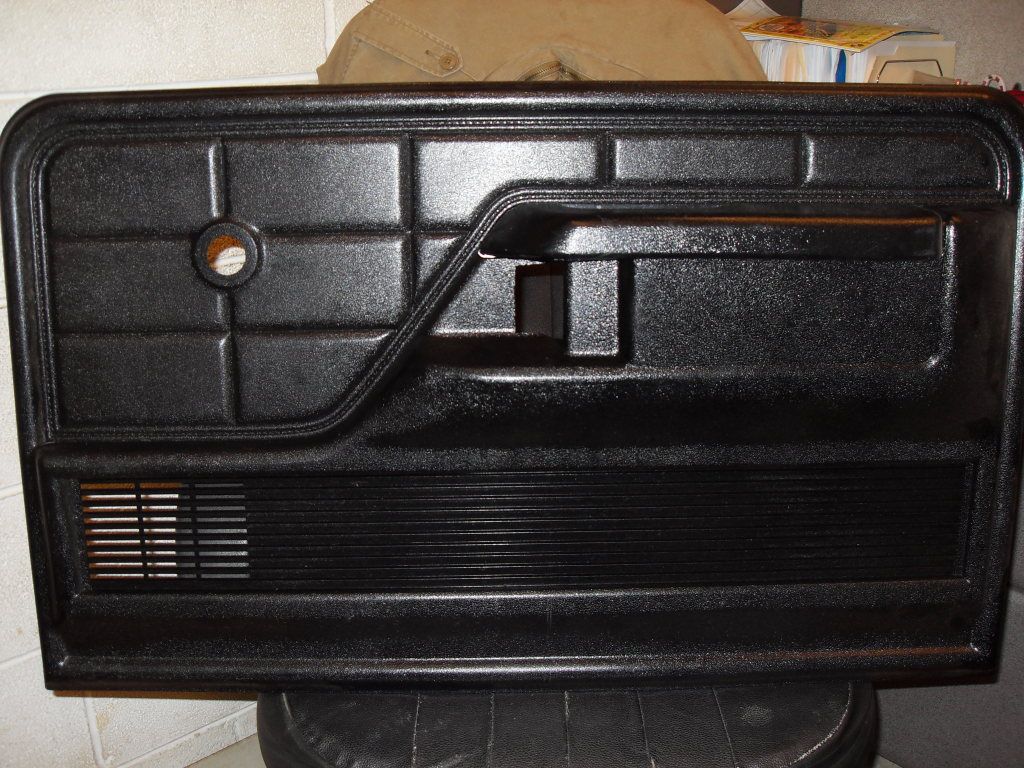

Good advice....also be aware that some panels have a slot in the tabs for the plastic clips and others that use the metal clips don't have the slots in the tabs. The ones I salvaged used the metal clips and did not have the slotted tabs.
Back side.....no slots
Front Side.....refurbished
Nice job on yours! Thank you, I will have to look at my old ones as I was unaware of the hole vs slot, the new panels i got from DC have slots and they are the ones made from Ford tooling, yours have holes, are they oem? repro? did Ford make both? Neither of the clips, metal or plastic stay in place in the slots as you try to align the others so here is a great time to use the scraps of Fat Mat sound deadener i saved, a 2" square keeps them in place, even if you use your door panel for a frisbee! I'm sure any tape would have been fine
