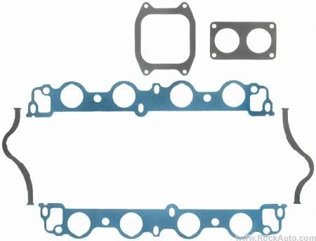

I'm looking for the gaskets for the EGR, Throttle Body and Upper Intake Manifold to Lower Intake Manifold. Problem is what all the parts stores and dealers have are wrong for my truck.
The gasket they have for upper to lower intake manifold is an open rectangle without the center column mine needs. The EGR gasket they have has 2 holes, mine has one. The Throttle Body gasket ID holes are way too small. Below are pictures of my parts. Any help would be appreciated.
My Truck.
1992 F-250 extended cab, 7.5l (460), 4x4, E40D, A/C totally stock.
All the parts suppliers and Ford dealer have gaskets without center divider.
The gasket they have has 2 holes for EGR
Their gasket holes are a good 1/4" undersized.
Lower intake mating surface.
This is what they are saying I need, both Ford dealer and local parts stores.
If anyone could get me the correct part number or let me know what I can do to find the right part your help would be appreciated. Where I live my best access to parts is Napa and O'Riely (sp?), the Dealer is a 90+ miles drive.
Thanks,
Bill

Lower gasket E7TZ-9H486-A
Upper gasket E7TZ-9E936-C
The other part you're looking at is the IAC, not the EGR
The gasket for it is E7SZ-9F670-A

BTW the center divider on the lower gasket is not nessecary, and the upper gasket should match the throttle body, not the intake.

Thanks, but the IAC is fine and was removed, cleaned, tested and reinstalled with a new gasket I already had from the work I did on my Bronco.
Upper Intake R.H. Side picture shows the single hole where the EGR (I could be wrong re EGR) is mounted. That's the other gasket I need.
I'll look up the gaskets you gave me the numbers for. Is that OEM or another brand part number?
Thanks,
Bill

EGR gasket E6FZ-9D476-A
Those are OEM Ford part #'s
