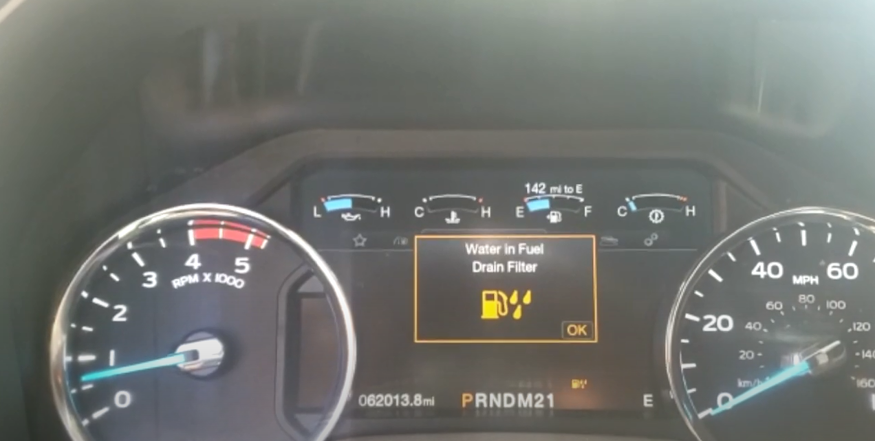

I found this image on YouTube. It appears some 17-19 trucks are getting chaffed wiring on the WIF sensor wire harness causing this to illuminate.
Thins would sound a DING just like any other popup. I hope to never see that.

There is a ding, the WIF light comes on, and the display tells you to drain the water separator, very hard to miss. I got it a few times after driving through heavy rain - it's the connector getting wet.
