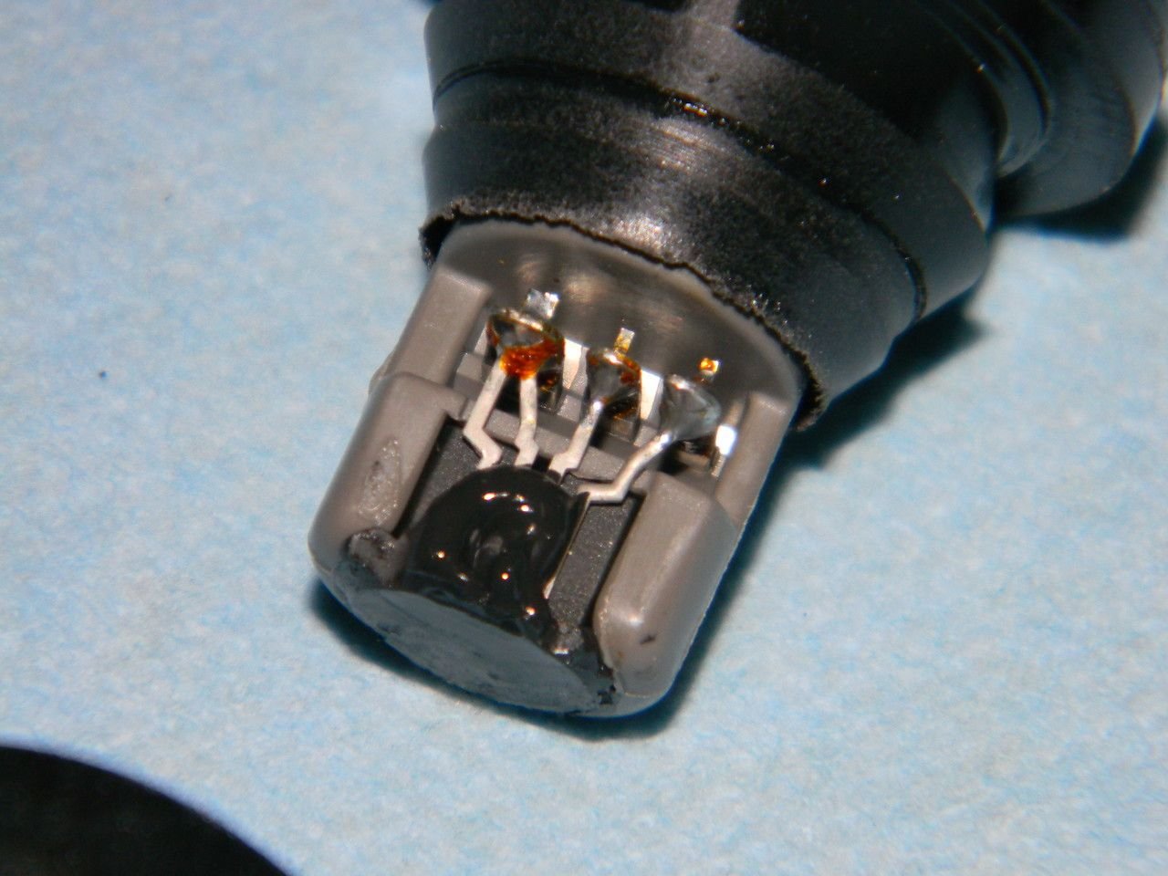

I had a CPS removed from Josh's (JacksonJL) truck that would not show RPM when cranking on AE.
I decided to check it against a known good one today and the resistance was all over the place compared to the good one.
I decided to tear it apart so everyone could see how simple they really are. This one is thought to be a Borg Warner CPS.

Neat pics! Any idea which component failed?

So is the colored stuff on the solder connections rust? Other than that, the solder joints appear to be in good shape. Any idea what caused the crazy readings?
And what did you ohm the good one at and what did the bad one read?

I am guessing the magnetic pick-up in the end failed.
Chris,
The connections had some sort of dielectric grease or something. It all wiped off. There was also a black RTV like material around the magnet connections and in the middle body section.
Here is what I measured on them.

So possibly some sort of internal short to ground from the CMP signal pin? Is the magnet strength affected any?
The magnet seemed strong still. It may not be as strong as the OEM Black ones though. I know the gray one is not near as strong as the black ones.
Was it Curtis that did his tests on the magnet by picking up different size washers to compare magnet strength? Sounds like a worthwhile test, especially if you can find a good BW part and compare them.
