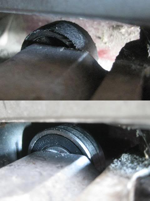

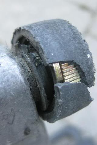

This has been done before by others. Here are my superior pics.
Your sliding door takes lots of effort to operate, the dash shows that it never closes well, and the door lock actuator stops responding. What to do?
Replace the lower bearing that is supporting the front edge of the door.
Long ago it was discovered by others that the common 1614 bearing has approximately the same bore and diameter as the Ford bearing. Whereas the Ford bearing, if available, might set you back more than $30, this common substitute can be had for less than $3. (Thank you, USA Bearings & Belts). The specs on the substitute are: 1-1/8 dia, 3/8 bore, 3/8 width.
Support the door, unbolt the lower bracket.

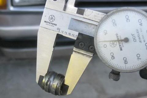

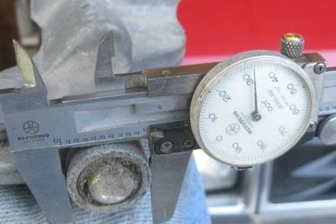

My original diameter measured 1.030". Others have reported the disintegration and loss of the rubber tire, bringing the diameter down to a knarly 0.950"

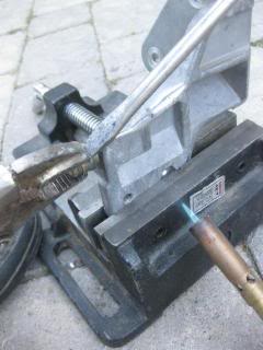

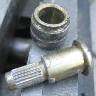

Put the bracket in a vise. A chisel or screw driver quickly separates the tire and bearing cage from the inner race.

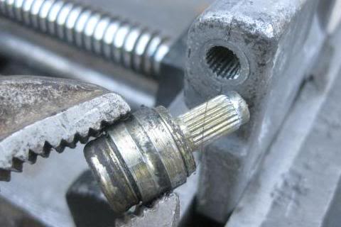

Grab the inner race with vise grips. Like others, I found that heating the bracket was useful.
Tap the pin out of the inner race.
Just checking. Yes, the pin has a diameter of 3/8".

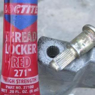

Use a thread locker and tap the pin thru the new bearing and into the bracket.

After installation, the door just glides across smoothly, using perhaps 1/3 the original effort. The dash shows the door closed, and the lock actuator now receives power to operate.
Old v. New
