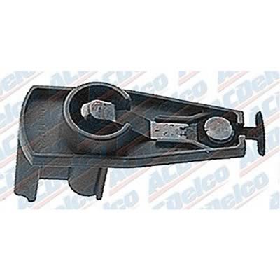

Let's say that I have taken out my old distributor from my 351W and rotated the crank and I now need to line up a new distributor.
I have a mark on my distributor base where the #1 piston wire connects to. But then I was thinking about the rotor in my distributor that has an electrode end that is about 1/2" wide (the side on the right here: http://static.summitracing.com/globa...acf-f426_w.jpg).
When the rotor rotates in the distributor, what is considered 0 degreed, TDC? Is it when the leading edge of the electrode starts to cross the #1 wire? Or is it when the electrode is lined up in the middle of wire #1?
I am trying to figure out how to determine if I got the right tooth on the cam gear when inserting the new distributor so I can set the proper timing.

All you need to do is have it at TDC on the comp stroke , then drop the dist in so the tip of the rotor is pointing at the # 1 on the cap , and you still have room to move the base of the dist to set the timing , the rotor will turn when it slides on to the cam gear , it dosn't mater what tooth its on as long as you have room to turn it to set the timing , if its to close then pull it up and move over one tooth....
