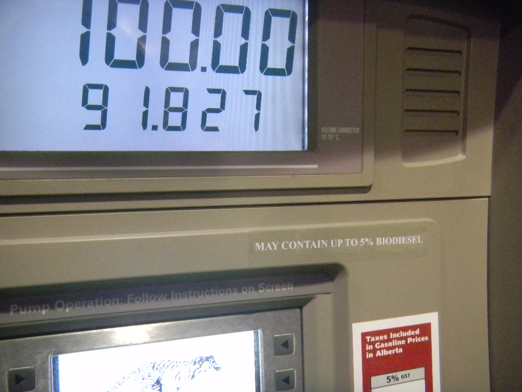

Sometime last year the stickers showed up at pretty much every brand of retail fuel indicating bio or ethanol blends... whether it actually does contain a blend you can't tell just by looking at the fuel. The receipt now also states 'BIODL' instead of 'DIESEL'.
Small amounts of biodiesel is great for lubricity isn't it? It's not like Ethanol blends that don't work as well in gasoline engines not tuned for E10 operation and therefore experience reduced performance. I'm not worrying.
