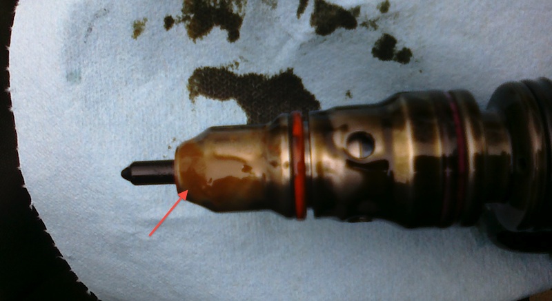

I also have never seen pics of 'failed sealant' on e99 from ELC.
Clay posted a pic sometime back. I'll see if I can find it.
Stewart
Old Feb 10, 2012 | 07:06 PM
Stewart_H's Avatar
Stewart_H
Joined: May 2004
Posts: 29,380
Likes: 118
From: Central Coast of CA
Found it.
Originally Posted by Riffraff Performance
Here are some pics to show what happen when you use it on the incorrect year.
The red on the end is Red ELC mix with the loctite it dissolved. They had just started to push past and it was only on 3 of the 8 cups. But when we pulled them almost all turned in the head and didn't have any loctite left on them.
As Gooch say's, "To be certain, the problems found with the older type of sealant used during injector cup installation, which doesn't mix well with an OAT ELC, is enough to stop someone in their tracks."
