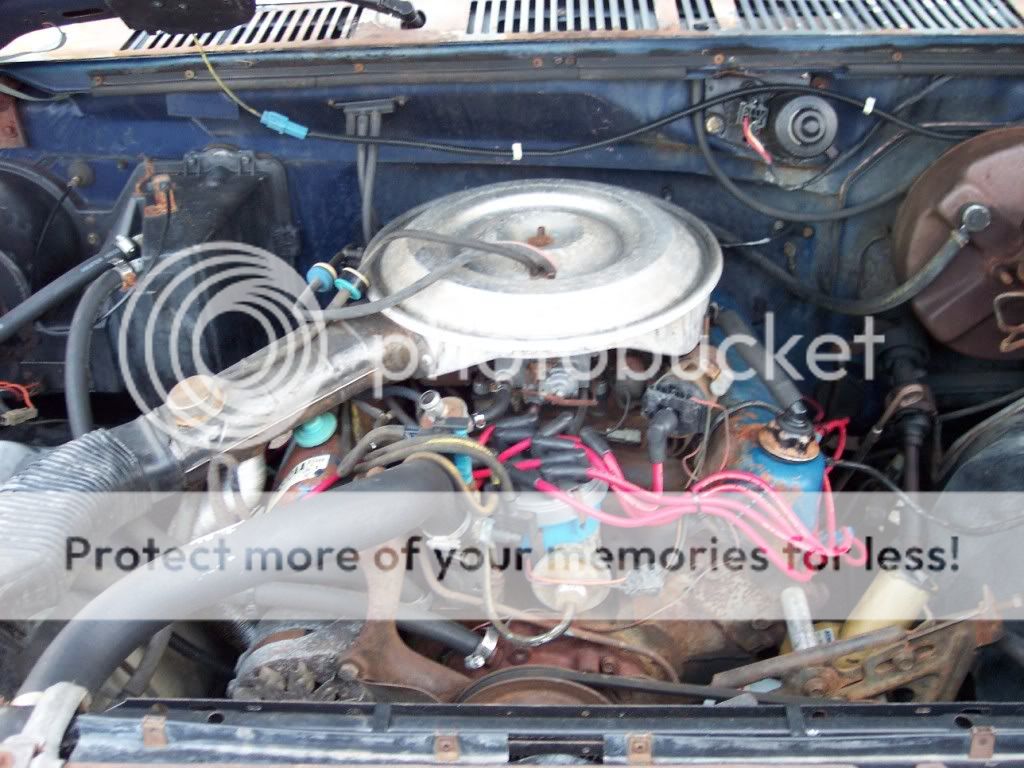

Getting my knuckles bloody doesn't bother me. And, I've got some 2in pipe left over from putting a new exhaust on the wagon this week. I've priced out the belts at O'reily. Looks like $20 or so. The missing vacuum pump scares me. Sounds like someone tossed it while trying to fix a larger issue? I'm not sure what could go wrong with it, or what it does for that matter haha.

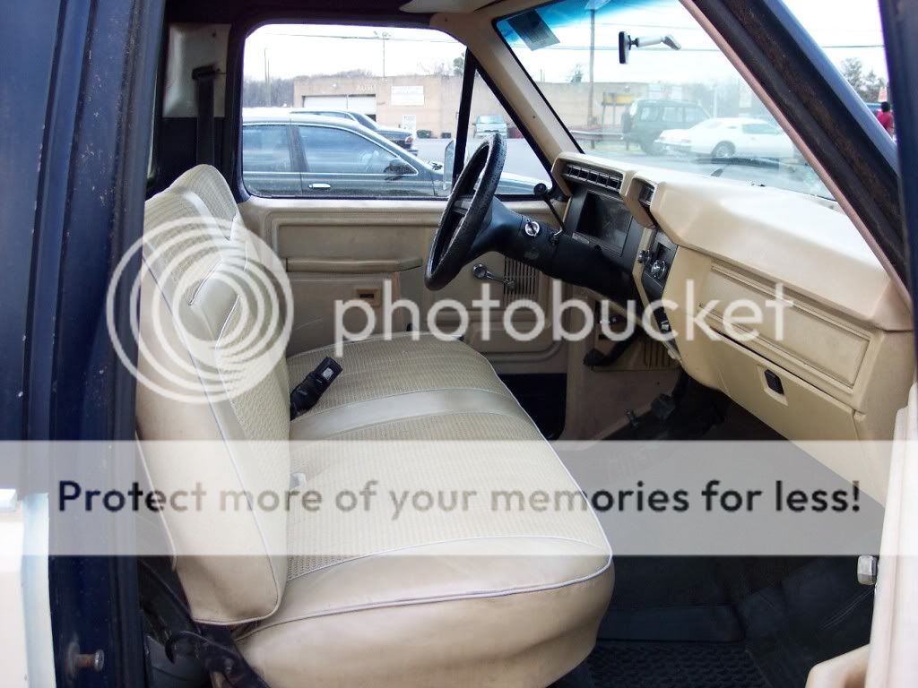

The price is listed at $1k. I figure I can walk with it for $800. Any thoughts, help, or concern? The floor pan mention makes me think there's a leak that pools on the floor and rusted through? Also, the column shifter means this could still be a manual right? I'm having a hard time spotting a clutch from their *wonderful* picture.

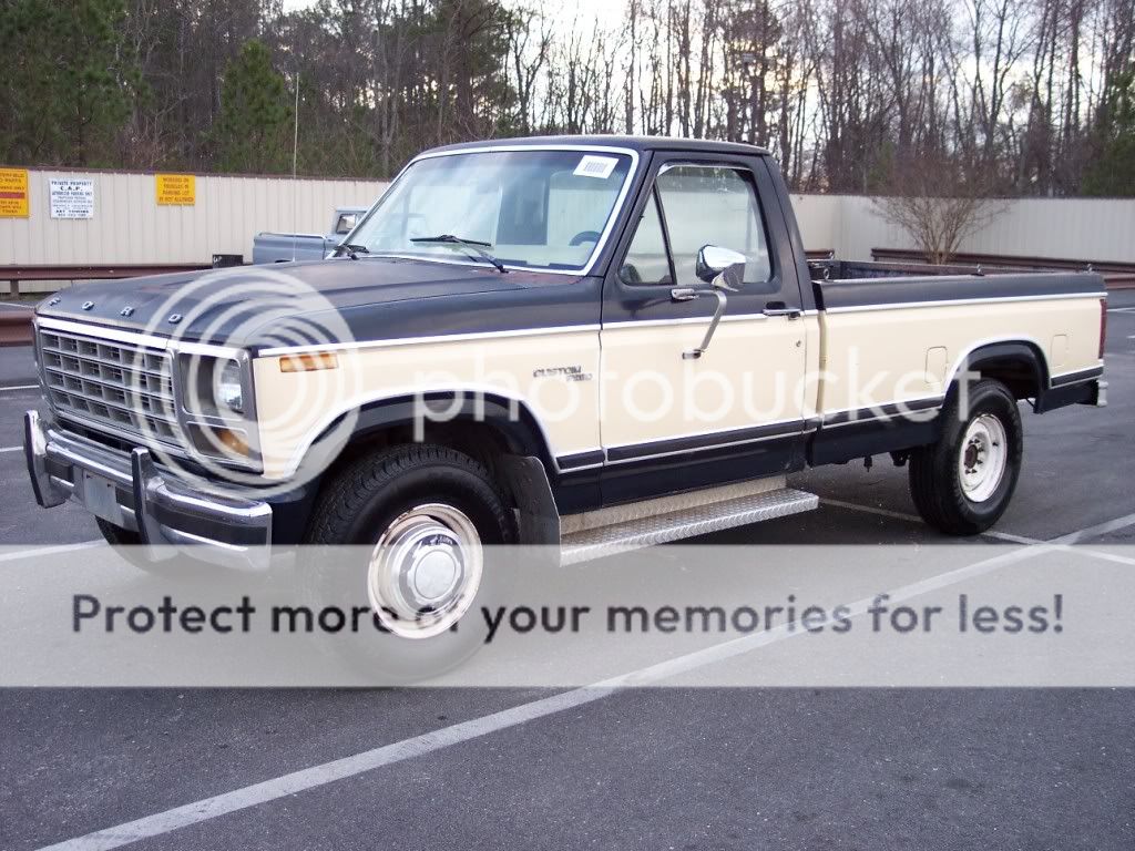

Looks to be either an F250 or 350 to me, since it has those 8-lug wheels. The pump they were referring to was the smog pump, which isn't needed unless you need it to pass inspection. There is a right way and a wrong way to do away with it, but I know little about that aspect so I'll let somebody with more knowledge chime in. From the pics it looks like an automatic, the 3-on-the-tree doesn't seem to be too common in these trucks. As for the floor pan, you'd just have to check it out. It may not be bad at all, but even if so, the rest of the truck looks nice enough to me that I'd spend the money to fix it.

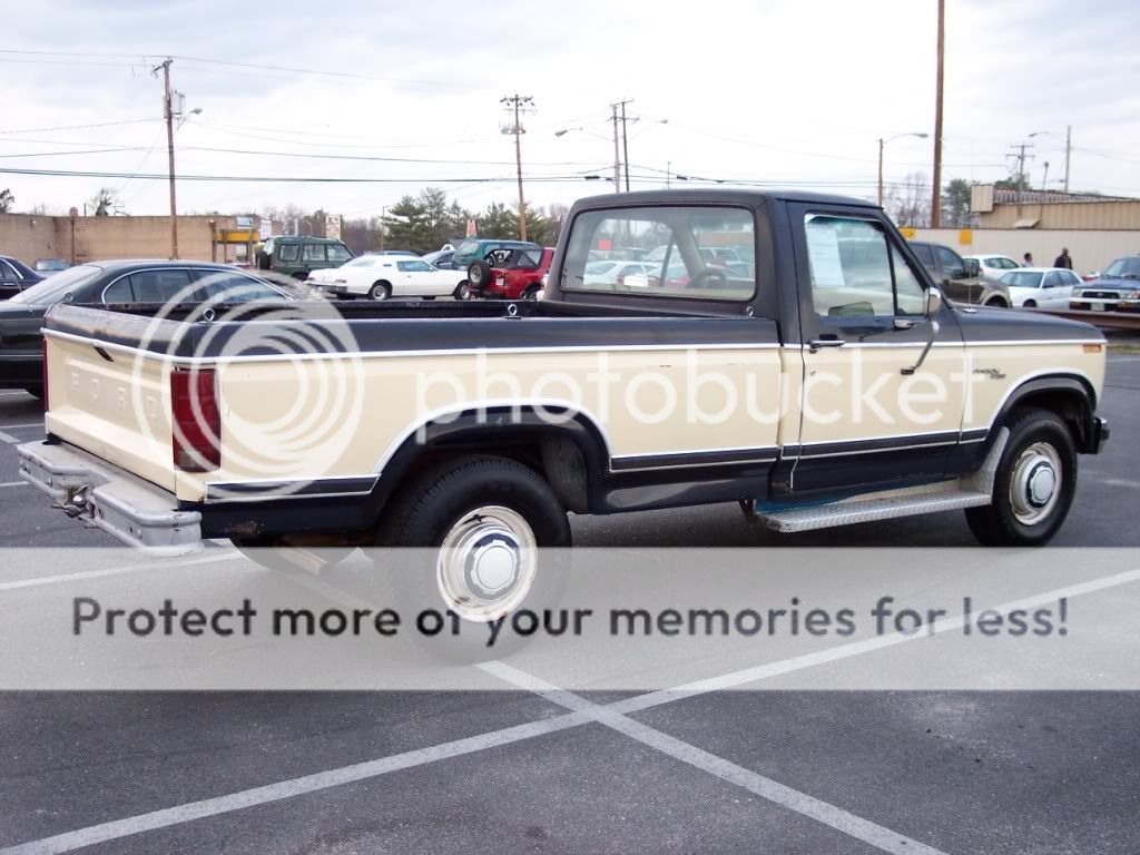

A few things I noticed. The truck is definatly an Automatic from what I can see. But heres the thing. If you look the right tail light looks like it needs reassembled back onto the bed of the pickup. I see a melted harness it appears near the distibutor on thoses wires. I circled in red where I can see it I may be mistaked but it looks like it to me. It also looks like to me that the truck has more than 106K miles on it. Judging by the surface rust around the engine I say this I could be wrong again but I really think so because my dad's 86 has 131,000 miles on it and it doesn't look like this but could be your area. It looks also as if the power steering pump has been replaced which is typical in theses years Fords same with the altenator. It looks as if the truck has been taken care of other then that though. I would see whats the lowest they will take if not under $800 try the $800.

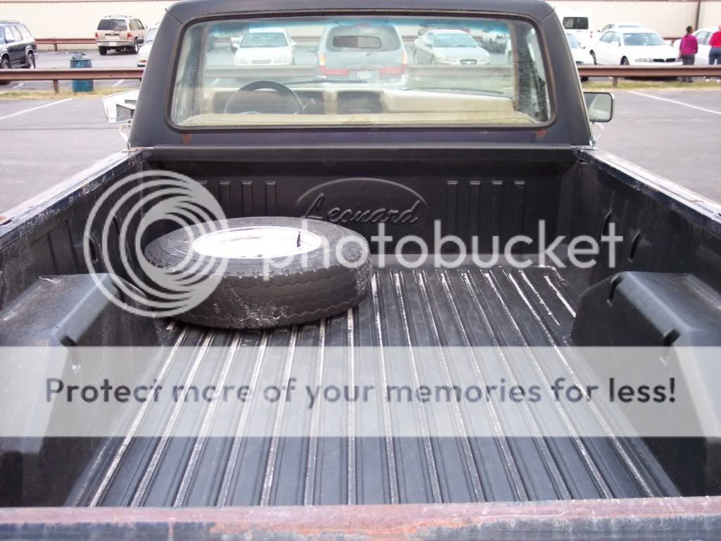

I would pull that bed liner out and see what it looks like underneath. That description is wrong like the other posters said, it has 8 lug wheels, so it's a f250 or 350. If it has f150 emblems on the fenders, then they have been replaced at some time.

Yea, I don't see the clutch pedal in the pic either. I'd say auto. The truck has been painted over at some point. You can see the over-spray in the door post and on the PS running board. This truck might in fact be a frankenstein due to previous damage, hence the F-150 badges, and the 8-lug wheels.

The outside door mirrors aren't original factory and have been replaced.
The engine looks to be a 351M which doesn't mean anything significant by itself but I wonder why they removed the smog pump.
I can't see the vacuum lines real well but I'm wondering... the one that goes to the distributor, I'm wondering where the other end is connected and what that black assembly with what looks like vacuum lines on it (on the radiator hose neck) is... is that the factory connector to the VCV (Vacuum Control Device), or what?
Yellow arrow is the automatic transmission linkage.
Red arrow is what looks like a vapor canister purge valve, the GVWR rating is going to determine if this is present or not from the factory (my 1981 F350 has no such device, nor a vapor canister; I don't remember if the F250s did or not, look at the sticker on the radiator support).
On the whole, the engine looks relatively complete.

The steering wheel is aftermarket, make sure the turn signals (and automatic cancellation), emergency flashers & horn work.
Looks like the wiper motor has been replaced, make sure the wipers work correctly.
The truck doesn't have air conditioning yet it has a vacuum tee/distribution block screwed to the firewall, how odd. Maybe a one-year-wonder thing and doesn't mean anything significant by itself as it looks factory in the pics.
The rust & corrosion on the engine makes me think the odometer has rolled over at least once.

Correct me if I'm wrong, but does the decal on the PS Pump make it look replaced also?

If the decal has a bar code, yes.
An original sticker would be a "Do Not Pry Here"-type of thing:

If my eyes do not decieve me, it says A1Cardone...Which is a replacement pump...

That sure doesn't look like a "150" to me... More like a "250".

Definately a F250. 8 lug wheels and big "dog dish" caps. Rear axle is semi-floater, so it's a light duty F250.
Engine does look to be a 351M/400, and trans looks to be an auto from the interior and underhood pics.

Yep, there's certainly some new parts under the hood. Yet the water pump has...patina?.. so I'm thinking original or an older replacement. And yes, it does appear to be an F250. It's listed as that in their inventory, and when I blow up the fender pic that's what I see.
As for the smog pump, it's not uncommon to see issues with exhaust equipment around here. Road salt isn't much of a problem, but humidity and temperature swings are murder on cars around here. So you don't see as much frame rot, but things like mufflers develop holes commonly. And, it's also possible to drive for a couple hours around here without leaving residential roads. So engine speed stays low and cats get cooked. My benz just recently got hollowed out cats . There's also no emissions inspection, so my only concern with the pump is that it was removed correctly.
