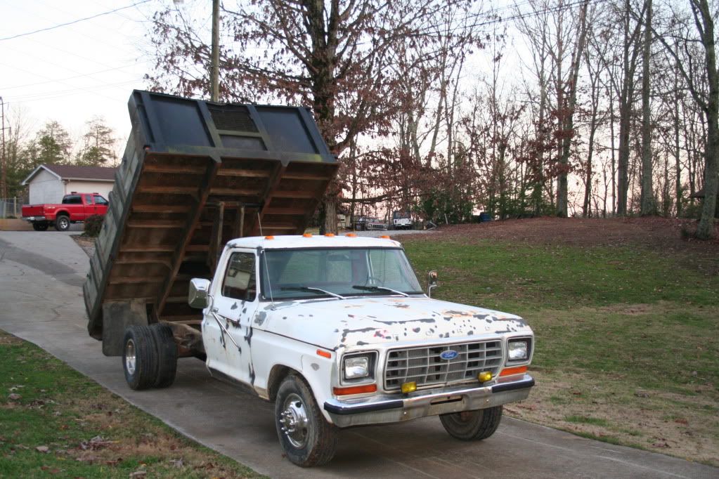

I just bought this '79 F350 2wd dump and am looking to convert it to 4wd. I have a king-pin D60 but it's a later model '85 or so?
Since the F350 is coil sprung, I've entertained the idea of using radius rods and C-brackets from an F150 and keeping the coils. Problem is the diff housing is much closer to the knuckle than it is on the '79 style D60. I dont think there's enough room to weld on the c-brackets?
Of course using leaf springs will work OK but as thread #3 details, there's gonna be a lot of fab work involved. I own a machine shop business so that's not a problem other than the time involved.
I have two '79 F250 4wd truck for donors. Both have 435 trannies and 205 TCases plus other goodies I will need.
The F350 has a T18 but I believe the PTO gear box will fit the 435s?
Anyone have advice/suggestions?
BTW...to the OP....I will be scrapping the two F250 4wd frames. One is good...the other not so much.
Not sure where your located but.....?
Here's the F350 as bought:
One of the donor F250s....has a D44 front
