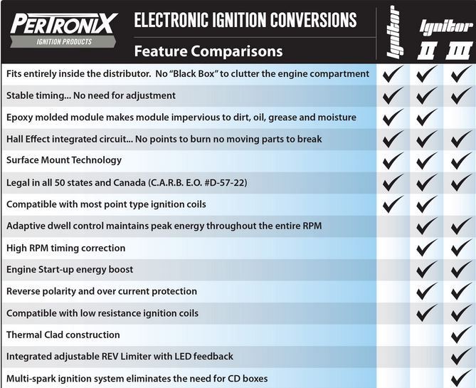

The ICM has a constant BAT VOLT supply (RED), the same in RUN and/or CRANK. The resistor BY-PASS is only used to make the coil momentarily hotter for an easier START. The WHITE wire retards IGN LEAD while CRANKING to make starting easier and to lessen wear on the starter motor.
The system is fine if it came OEM, but if retrofitting a older ignition system, PERTONIX II is much simpler (IMO).
Either FORD DS II ICM or PERTRONIX module is subject to failure, as are all automotive components. The MAIN PROBLEM(s) I have observed is incorrect application and/or install. Stay away from PERTRONIX I.
A Pertronix is probably a better solution for a "mostly stock" build, and even up into lower-end performance. Once you get past that, you can worry about timing stability at high RPMs and a host of other things.
If you have a racing type motor in your pickup, you need PERTRONIX III -
