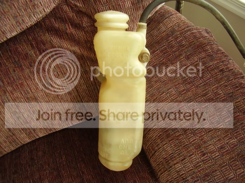

Thanks for that app info, Bill. Here's a pic of the D1TZ jug.Scarce as they are, funny thing is one wrecker I've been haunting for the last twenty five years has supplied me with five of them.
mike
