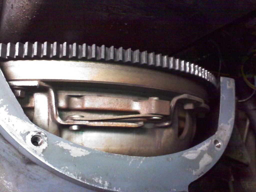

Truck hits 25 psi of boost and then the clutch starts slipping. So I've been researching clutches. I'd love to save myself $280 and not have to buy a flywheel but I can only do this if my truck already has a SMF installed. IF it has a SMF installed, and I machine the surface down. Do I have to shim the back of the flywheel to match? ( A mechanic friend of mine was curious and brought it to my attention to ask you guys)
So I took a picture of it, hopefully someone can steer me in the correct direction on what it is.

That looks just like my Valair SMF and clutch setup.

That's a single mass flywheel. Just take it to the machine shop and have them surface it. No need for shims or anything when you put your new clutch on it. If you are looking at the Valair clutches, pick which one you want, call up there and talk to Gary or Dan. Tell them Cody from Death Row Diesel sent you, and they will hook you up with a better price than advertized. I like to pass that on to all my Ford guys. Dan, Gary and I all pull together, and they are good friends. So I like to send business their way when I can, and in turn, they take care of my people. Hope that helps man.

Thanks Cody. That means a lot to me. Also thanks for confirming that is a SMF. That'll save me from having to buy a new flywheel.
