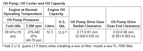

Go with an electronic HPOP gauge. It just pigtails into the ICP sensor. Very easy install. You don't want a mechanical gauge or it's plumbing to burst. Remember the HPO can reach 3000 PSI and more.
I have an aftermarket coolant temp gauge because the factory coolant temp gauge does not appear linear but will move in steps. Cold, warm, hot and TFL.
A small digital volt meter that plugs into the power point is inexpensive and worth having.
Ford low pressure oil specs.
