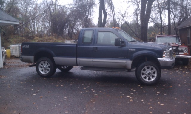

sorry i didnt search this first, I got 2010 wheels when i bought my other truck, they look great on my truck! Is there any reason other than that they will rub when turning that I should not use them?

They will rub when turning. That and when you look at it from the front or back, the wheels will probably look like they're in too far. Kind of like some of those railroad pick ups look like.

Just trim that bottom plastic at a 45 degree angle and you are GTG. I am running 37’s so I have more of an issue with rubbing on the springs.

no they will rub his leaf springs not his bumper. the "coil spring" year rims ride inboard on "leaf sping" year trucks.

Yea exactly, I drove it to and home from work and a little bit around town. They hit the springs but I can get 1 3/4 turn on the steering wheel before they hit, so not too bad just for testing them out. The truck rides so much smoother at highway speeds. I had my old wheels re balanced but I guess they are just not as good as these ones.
I might get spacers so I can keep them =/

its not a fan favorite around here but i have two inch spacers on mine. i picked up brand new 2008 18" wheels all 5 with center caps for $500. so i'll keep them on until the tires are no good. everyone will also tell you that you have to have hub centric spacers. i have lug centric on for two years with no problems.
