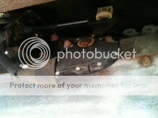

Would this be the switch in question? I assume it is. Looks like two bolts to remove it?
Old Nov 5, 2011 | 07:00 PM
CrzHelm's Avatar
CrzHelm
Joined: Oct 2010
Posts: 210
From: Long Island NY
yes that be it, and " BLOCK YOUR WHEELS !!!! " I almost killed myself changing that switch.

So I removed the the two bolts and electrical connection. The trans is in neutral ( e-brake on, wheels chocked ) but I cannot get the old switch off. Do I have to remove the cable from the bracket? I tried gently prying on it but it doesn't want to move.

Did you remove the nut at the center that holds the shift cable on? Don't remove the cable from the lever, remove the lever from the trans.

Got it. The old one needed a little heat to get it off. It was seized on. I never took the cable off. Everything is working and this did solve the initial problem! Thanks again everyone. $50 later and it shifts like new. Wonder that would have cost me at the dealer.
I also checked the two torx bolts and they were also slightly loose.

Chock the wheels, set the parking brake, and leave the trans in neutral. Find the switch on the driver's side of the trans. Remove the nut that holds the shift lever to the trans. It's in the middle of the switch. Remove the lever. Leave it dangle on the shift cable. Unplug the wiring harness. Remove the two bolts that hold the switch to the trans. Remove the switch. It may be stuck and need some prying.
Put the new switch on the trans. There is an alignment mark in the center part that rotates. Align that with the corresponding mark on the body of the switch. Tighten the two bolts that hold it on. Plug the wiring harness in. Put the lever back on and install the nut.

Trying to remove the switch
Hi all,
First let me thank you all for the help and guidance you all post on here. I just bought an 2000 Excursion 7.3L and I am trying to replace this sensor. I can't get the darn thing off. I saw everyone posted saying to take the nut off the middle bolt but mine doesn't seem to be like that. The shifter arm and cable are behind the switch. How did OP get his switch off since his picture looks exactly like my setup. Are there keys that need to be removed to get the switch to slide off? Any help is greatly appreciated.
