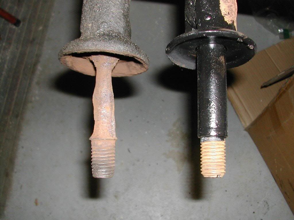

and here is why I needed to change the radius arms :-) ... got both installed this weekend, changed I beam bushings while I was at it...
Here is a test, can anyone tell which one is the bad one ? ha ha ;-)

Holy cow that's bad! All the ones I've ever had/seen look like the one on the right.

ha ha, I thought some people would appreciate that picture
;-) we have a little more rust issues up here in northern ontario than many other states would - I undercoat every year & drive infrequently in the winter, but the truck was driven full time for many many years & has paid the price !
