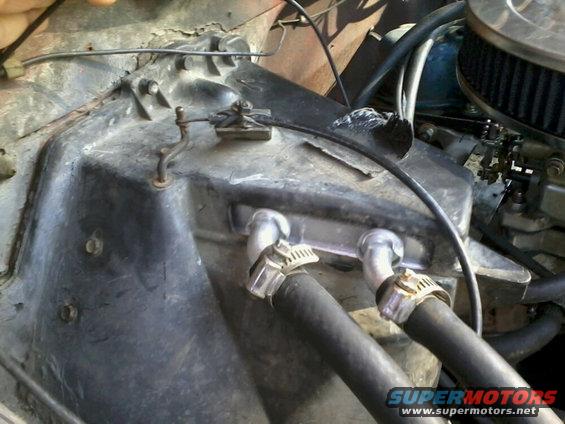

Broncos and full-size pickups from 1980-1996 all use the same heater set-up. I have changed out a core on one in less than thirty-minutes. There should be no cable under the hood; just the two hoses with no valve. Of course, someone could have added a cable-operated valve.
Both heater necks are on the same end of the core, so there is a baffle between them to direct the coolant flow through the core. I have seen new cores with bad baffles. You should get a minimum of 125 degrees from the floor vents.

The cable I'm referring to is the one that comes out of the cab and operates the blend door inside the box in the engine bay. When I move the lever in the cab, the cable moves and either swings the blend door shut or pulls it open.

Here's a picture of the cable in the engine bay I'm talking about:
