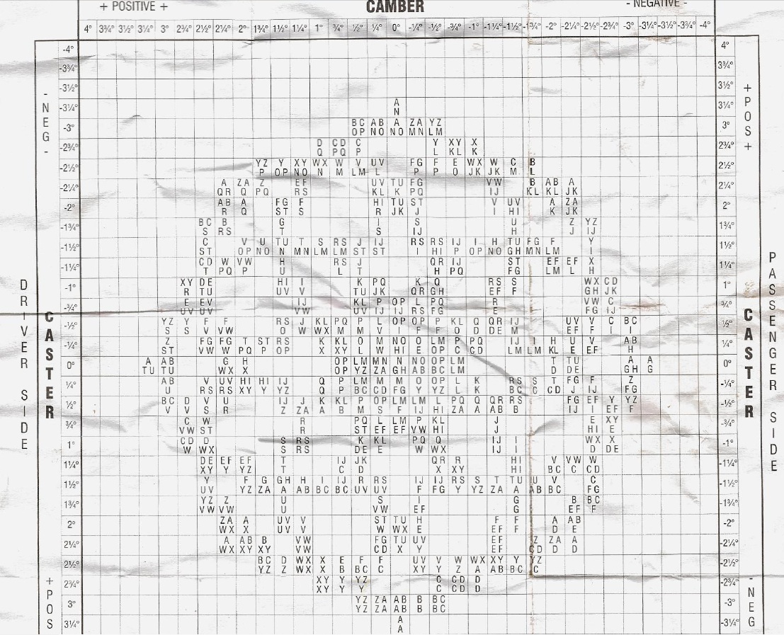

Originally Posted by Krewat
My alignment cams are indeed the 50421 part numbers.
So they are indeed "straight up" in terms of caster adjustment, with a .5 degree camber adjustment (I'm assuming it's "+").
So I think yo get what you'll have to get a dual axis type bushing like from Moog and Raybestos. Not sure I seen one in the Dan link you provided.
Here's a scan from the instructions that came with the Moog dual axis bushings I bought. If I understand it correctly it looks like you can use F/BC for drivers side and V/LM for the passenger side.

Old Oct 9, 2011 | 08:28 PM
Monster-4's Avatar
Monster-4
Joined: Aug 2007
Posts: 3,974
Likes: 18
From: Millersburg, OH
Originally Posted by hotroddsl
I don't think you cak use the MOOG sleeves with OEM joints, I'm not positive I was told by someone else, (an alignment guy) I have not tried myself!
Jim & fat Monty
I wouldn't understand why you couldn't. The bushing goes on the outside of the top ball joints stud so unless the stud was bigger with the Motorcraft ball joints it should work. Then again I have Moog ball joints so I won't be able to find out for sure.

Mike, that sheet looks like a brain-scan!
That Moog adjustable sounds like this (if link comes up right):
NAPA AUTO PARTS
At first, I was thinking one of the 2.25 or 2.5 degree cams would work, because they have 8 separate "cogs" to orient the cam, and just put it one cog off, but that would be far more camber than just .5 degrees.
Yeah thinking it through it does not make any sense the would have to be the same as far as size goes I'm thinking ^^^^^he mus have wanted me to buy the new cams! (it worked!) and that sheet is pretty intimidating at first but as I took a sheet o paper and covered the left side then used another to guide across the +11/2* caster it made perfect sense! you can pretty much set it any where you want this will be a neat Saturday project once I figure out my IDM problem...
