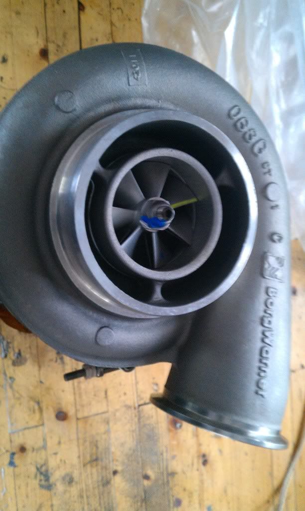

as promised, and youtube blows and wont upload my video but i need to make the down pipe, which is going to be interesting to say the very least! but tranny needs to go back in and then button up the rest of the intake i made and then drive her around!
incase any one wants to know how it is to install it... BLOWS. very tight tolerances

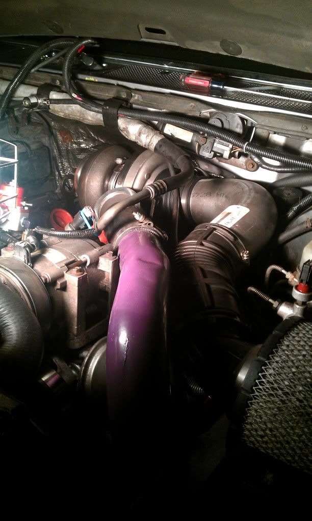

and thats just a rough idea of the intake, i cut it and it fits almost factory now! real happy with my outlet flange idea i have going too.

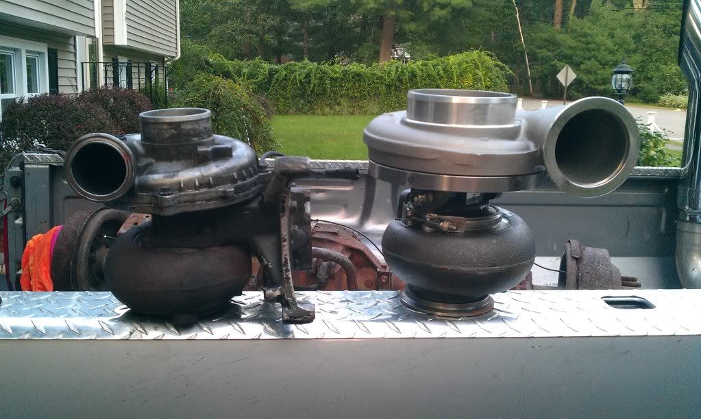

Thats one big turbo Steve!

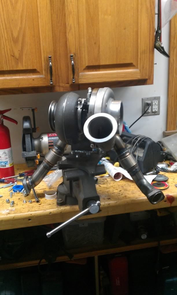

Are you planning on going with alot bigger injectors at some point? Seems like a really big turbo for 160cc stage 2's.
How made the mount kit? I like it.

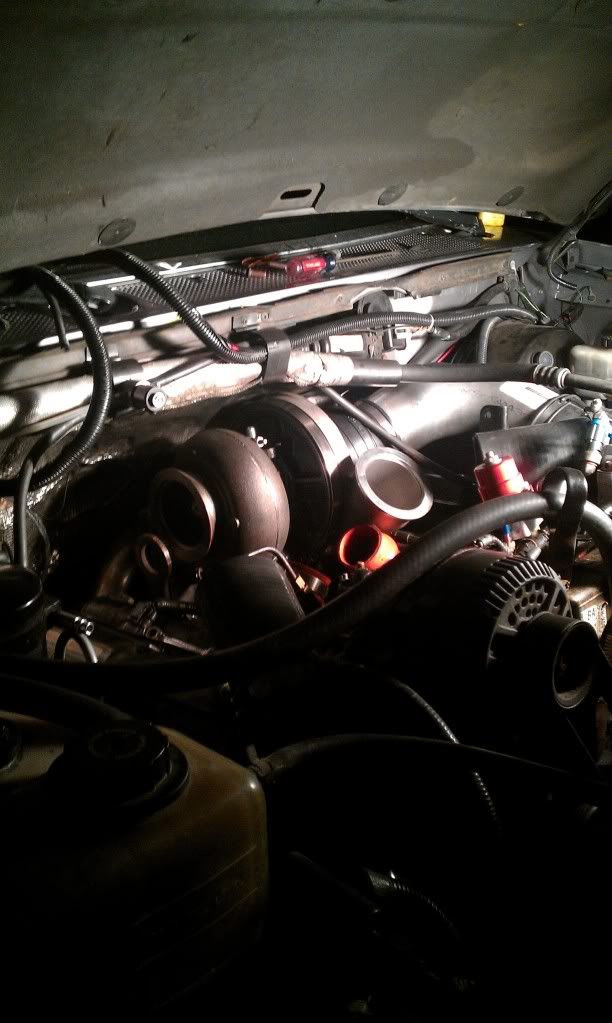

Yeah I'm going 250 100s I decided. This down pipe blows, the kit is real nice but the pass side up pipe on line is so far up that I'm cutting into my floor... She will be driving tomorrow
Jake at irate diesel made this

Yeah, I'm thinking that passenger side bellow needs moving or a lower profile bellow used.. I think these style bellows are physically a little bigger than the interlocking ones commonly used.
