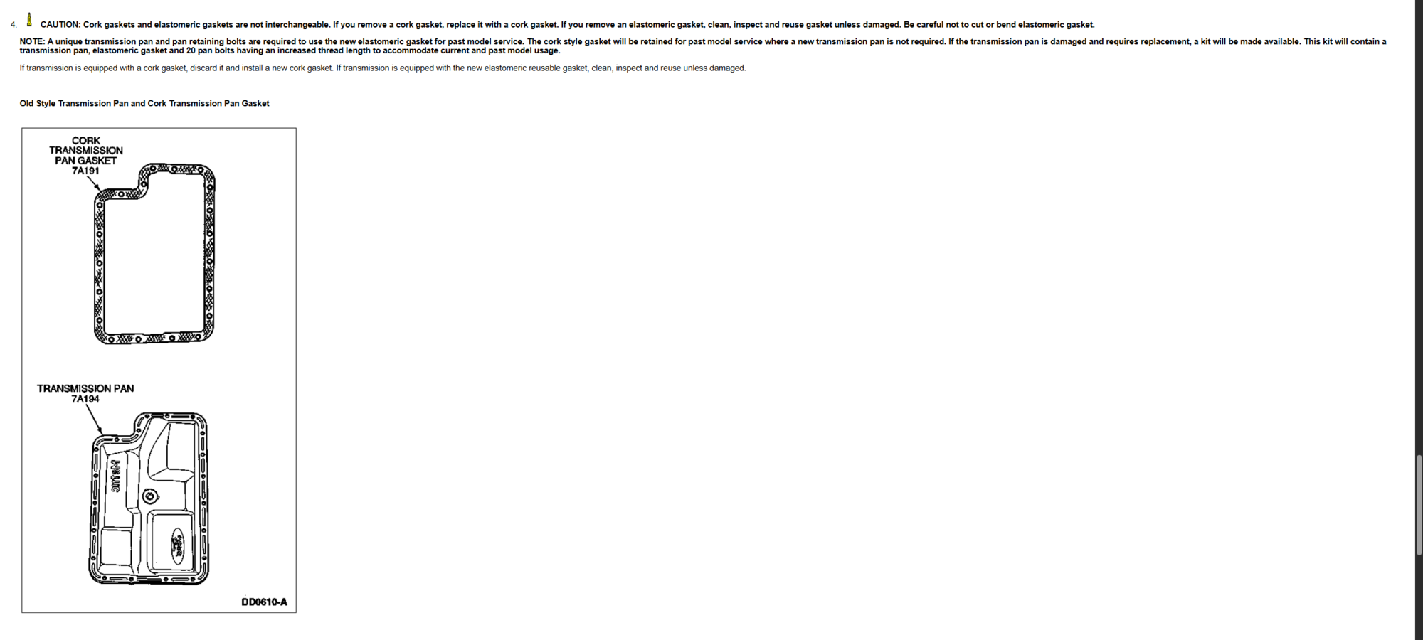

I would never use RTV nor an old cork gasket on a trans pan. I would use a cork gasket first but I'd never use RTV. In this day and age, there's no reason not to be using re-usable rubber pan gaskets. I stopped using cork gaskets many, many years ago. The best ones even have steal cores inside, though, I've never had issues with normal rubber gaskets without it either. Use a torque wrench and properly snug them down, this is the most important part. Like stated, don't assume someone before you did, and ensure your pan is flat and if it's not, pound the pan back flat and check any stripped threads. Now is the time to heli-coil any stripped out.
E4OD pan bolts are 10-12 ft-lbs.
FYI;
For any other future researchers (I see this thread has lots of views over the years)
You can upgrade to 4R100 trans pans too. This is a good time. The common ones are all E4OD 4wd depth, so you'd use them with the deeper 4wd pickup filters too. They have drain plugs. The part number is: #F81Z-7A194-BA
You can use them for 2wd trucks (w/ 4wd filters), wherever ground clearance isn't a concern (custom lowered trucks).

note if you wanted to go to the elastomeric pan gasket you would need new bolts and a new pan for a 2wd e4od (96.5-97) or a 4wd 4r100 (comes with a drain bolt) or a 4wd e4od (doesnt have drain bolt but 96.5 or later)
