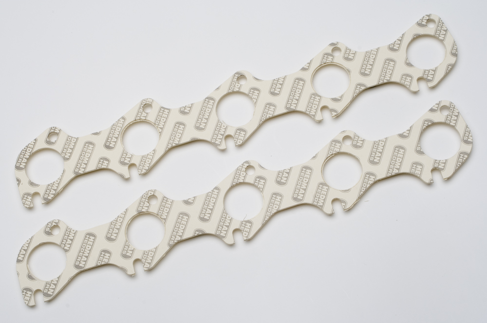

The manifold bolts that Hedman supplies are nothing special, just standard small-cap six-point header bolts. I've put a wrench on 'em a couple of times since the install and after the initial seating, they seem to be staying in place. I didn't use any sealer on the manifold gaskets, but it certainly couldn't hurt. The gaskets that they come with are a medium thickness fiber gasket, no steel.
I could have spent a few extra bucks and upgraded to locking header bolts and better manifold gaskets, but I figured I'd give the factory hardware a try first. I try not to spend extra money if I don't have to. Besides, I can always swap out the hardware later if it becomes an issue. So far, only the collector and CAT flange bolts have been an issue.
EDIT: Found a picture of the manifold gaskets on Hedman's website. It's part number 27580. The description on Summit's website says they are an acrylic bound paper gasket developed for Hedman. Take that for what it's worth.
