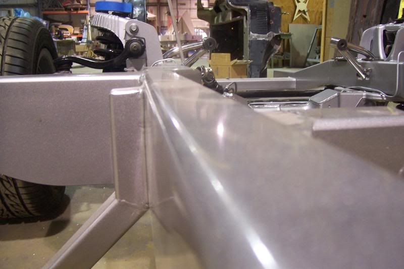

Hi folks........I usually hang around on the "Slick" side of town but I thought some of you might be interested in our build.
It is a 1956 F100. The frame was beat so we decided to build a new one...........

It's got an 8 inch rear...........
Front end had four inches taken out of the track........

We copied the stock frame except for the four inch narrowing front and rear,,
What do you think?

beautifull work, looks amasing!!!so is this the alluminum crown vic clip that you used? you sectioned the front end in the middle, how hard was it then to re-mount the rack and the sway bar??

Yes it is aluminum. We had to section the rack also...........and relocate the sway bar mounts, check the pictures again, you can see the mount we built on the side of the frame.

Yeh, after looking at the frame several times i kinda figured it was alluminum, clever way to mount the towers to the frame!
