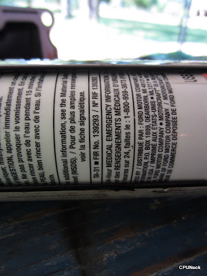

Yep, that will work, BUT don't do what I did and set yourself up for failure.
Doing the R&R for the turbo swap will be straight forward, as both engines will be out of the truck, but you have to pull the intake plenums. The e99 has smaller inlets from the 5-way spider that's attached to the turbo. You have to use the ubber speed RTV from Ford to do it. Looks like a "mini" tube of caulk, and is dispensed in a caulking gun. First time I R&R my intakes I was unaware of the special RTV, and used Ultra Grey (looks similar, but NOT) I'm not sure how soon my intakes leaked from the pressure, but after they almost fell off in my hand upon removal, it was probably with in a few months of install they started leaking.
<table style="width:auto;"><tbody><tr><td></td></tr><tr><td style="font-family:arial,sans-serif; font-size:11px; text-align:right">From R&R Intake Plenums</td></tr></tbody></table>
You'll want to take your time removing the stampted steel intakes as the RTV is a formidable opponent, and will easily bend and deform your intake, while attempting to remove.
Don't forget Turbo O-rings either, you'd be pretty bummed to get all this work done, only to find the turbo is puking oil everywhere. Good luck, it'll work out.
