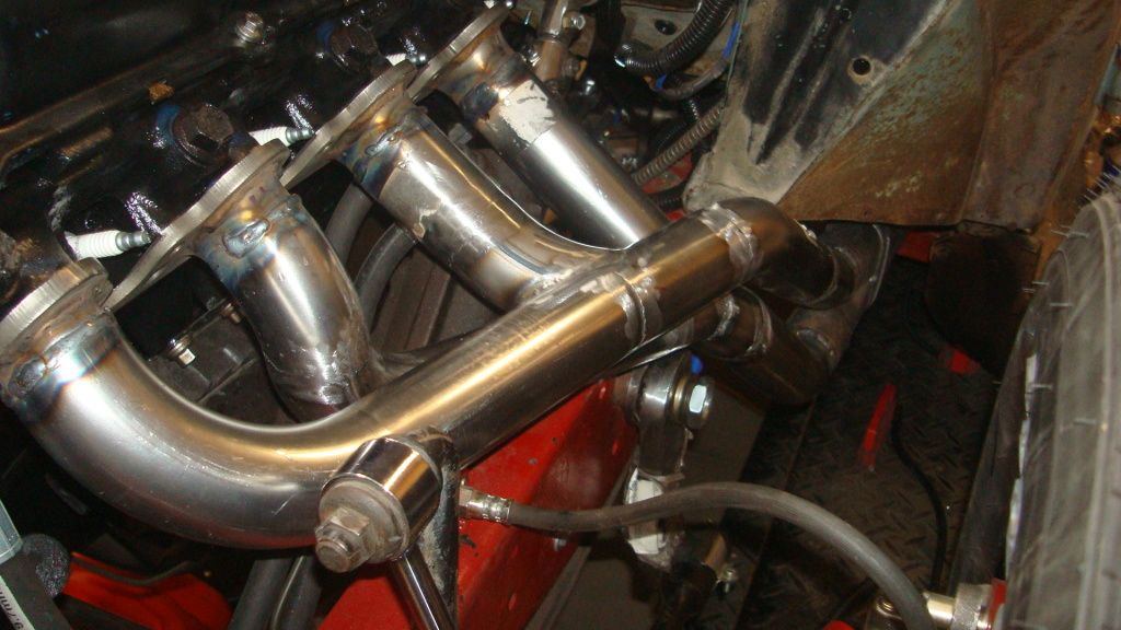

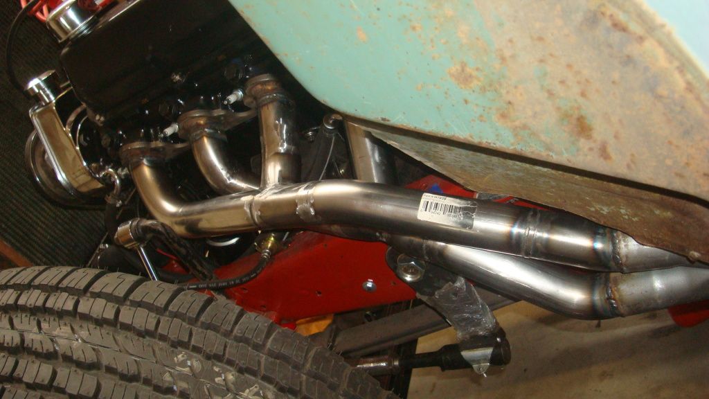

Are there no pre-fabbed radiators available for your engine/truck combo?
Those are definately some serious headers you're buildin. Looks good. Keep it up and keep the pics commin.

Headers done !!!!!!!!!!!!!
Started modifying the front bumper which is slightly smaller than the frame rails it's supposed to fit over so the torch was needed.
