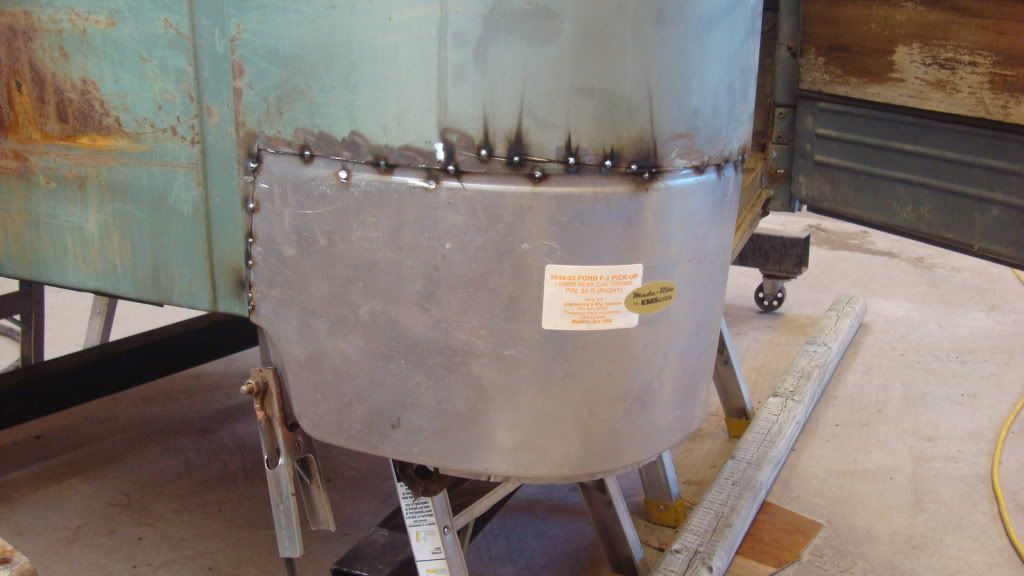

The only rusted through part of the cab was one rear corner so I got to work on that this morning.
Made the inner panel and then fitted the patch panel I bought,which although well made wasn't the greatest fit so I added a piece to it where the meets the door.

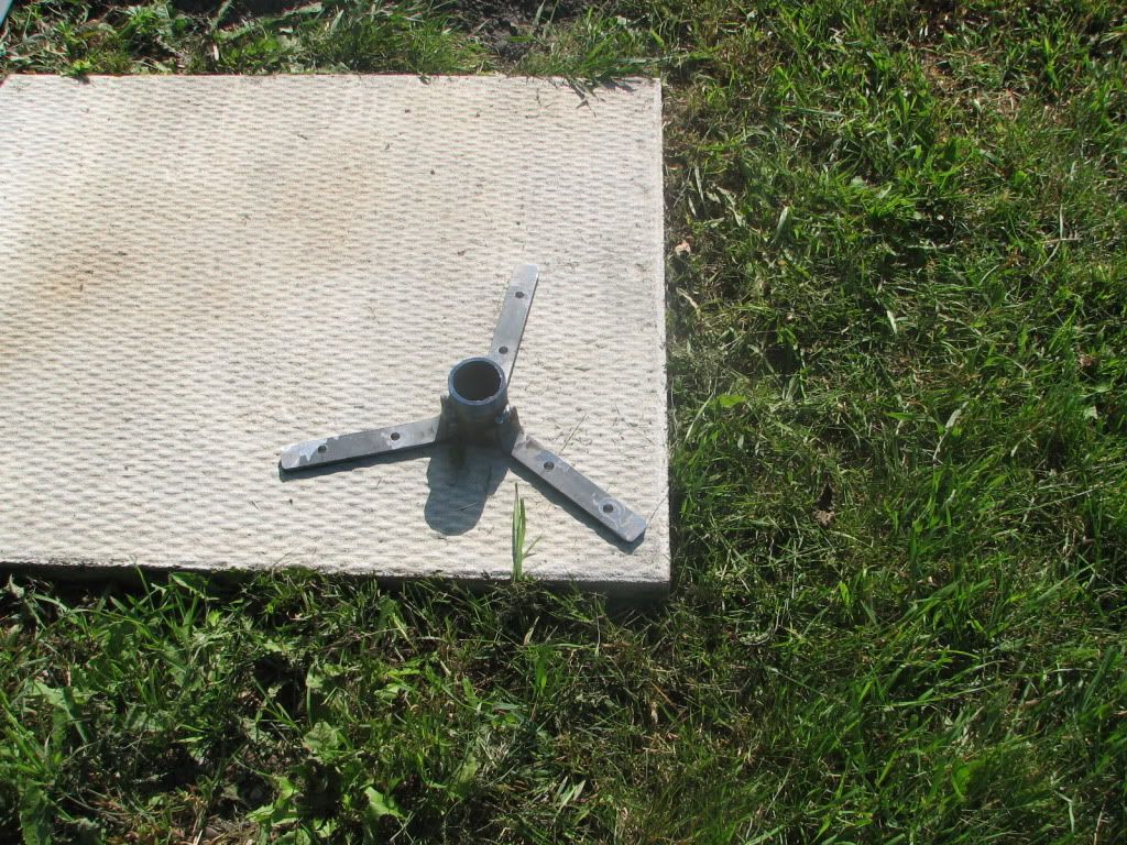

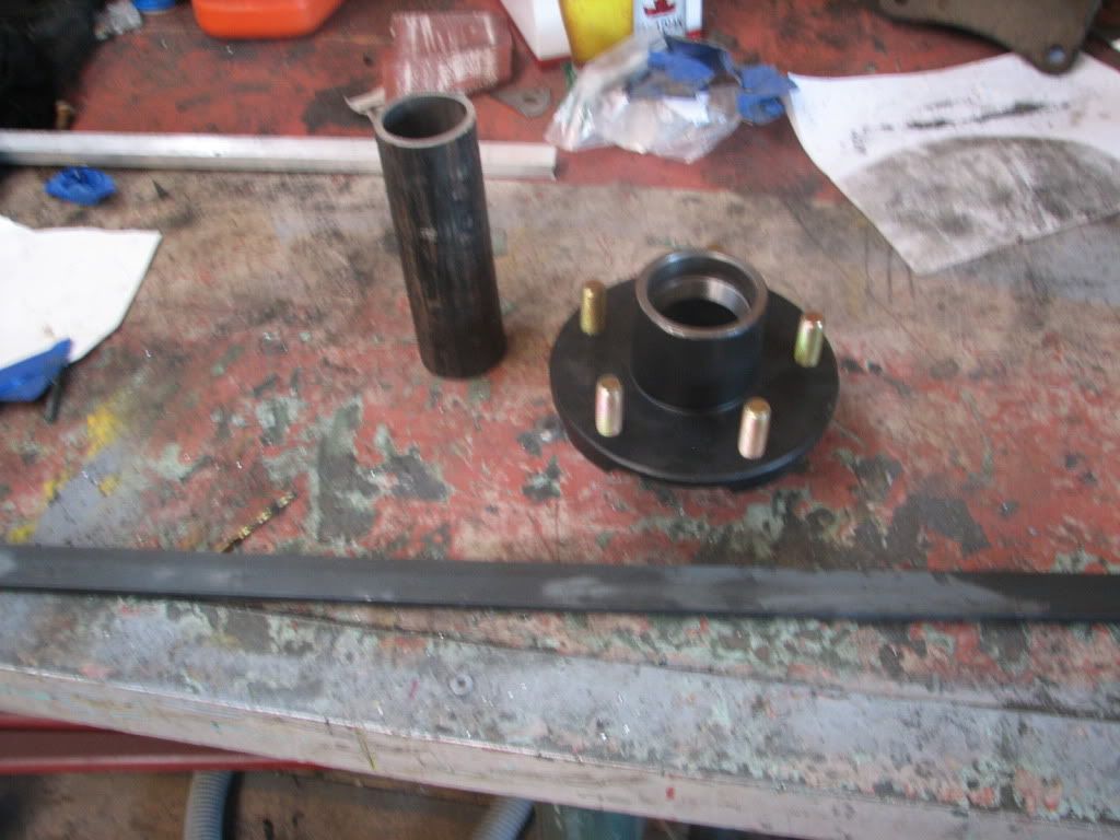

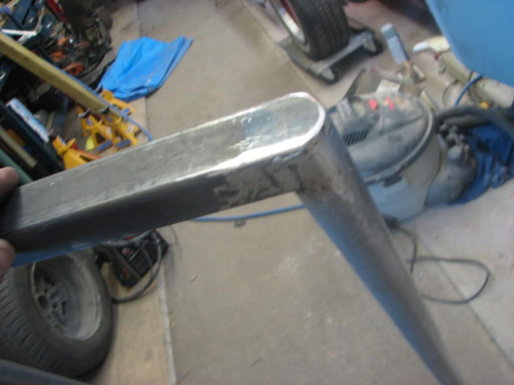

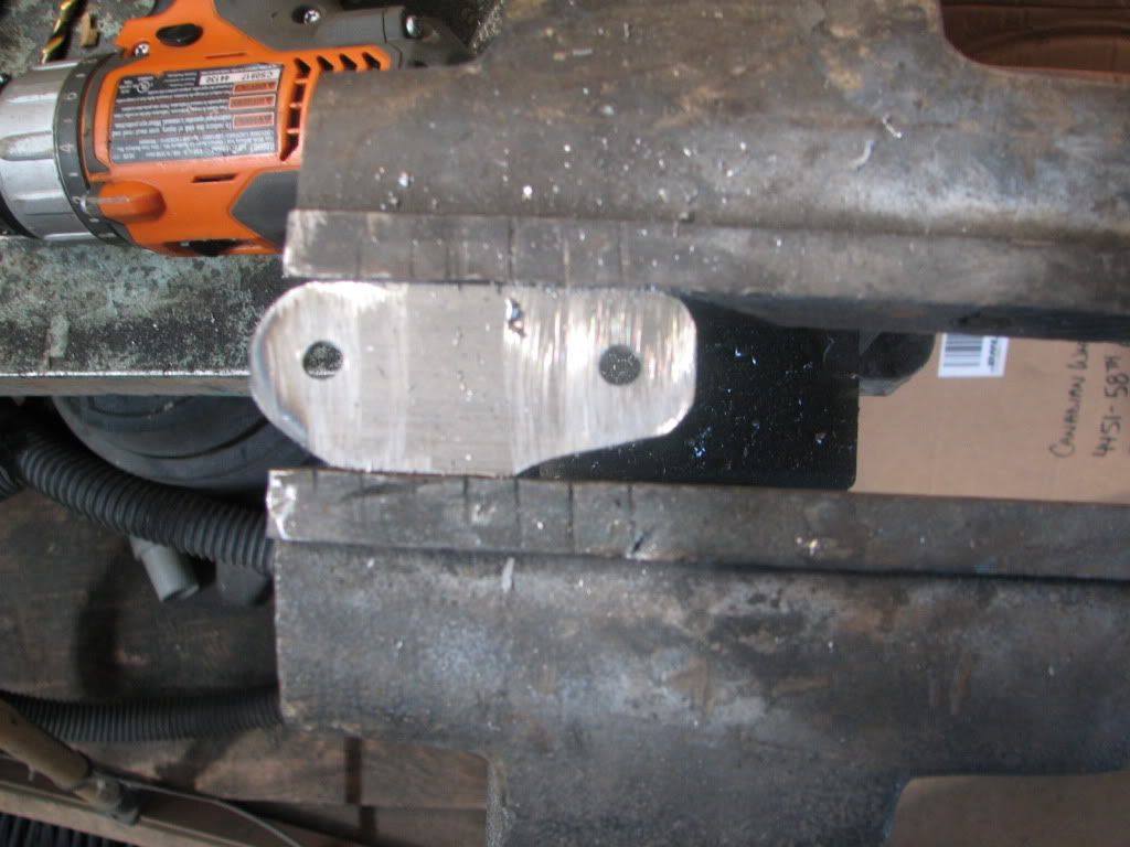

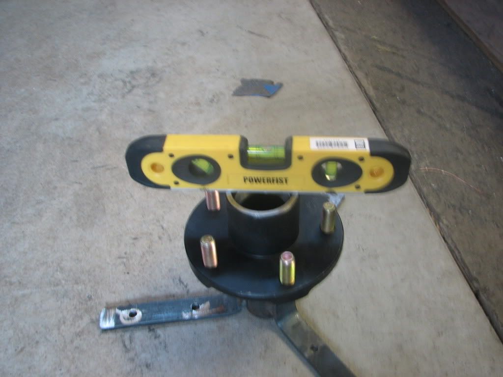

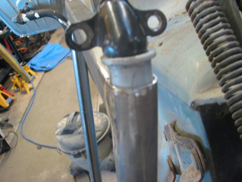

What do you get if you start with ,one hub,some tube and 3 pieces of flat bar?
Old Aug 8, 2011 | 09:23 PM
  #34
Englishbob's Avatar
Englishbob
Joined: Jun 2011
Posts: 135
From: Calgary,AB

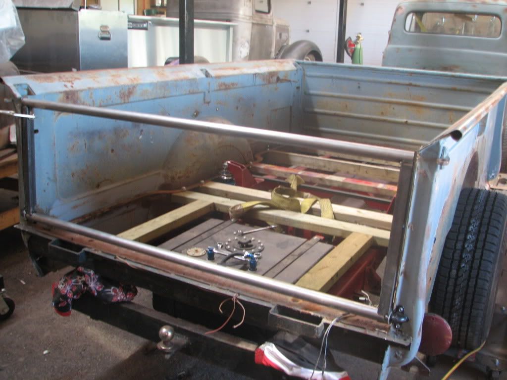

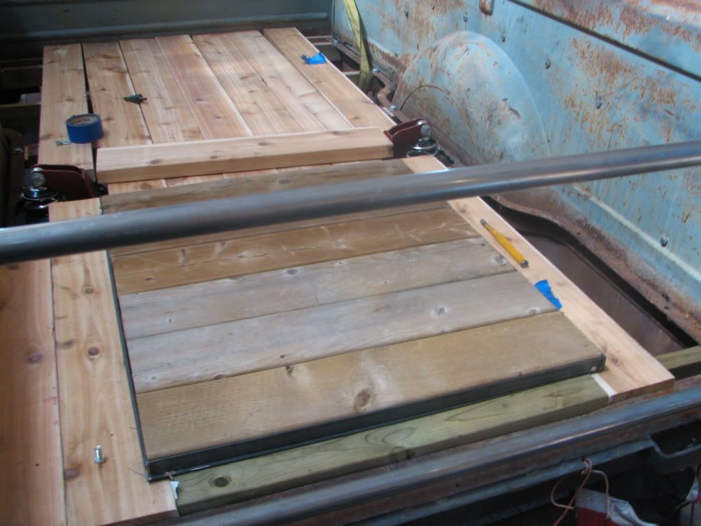

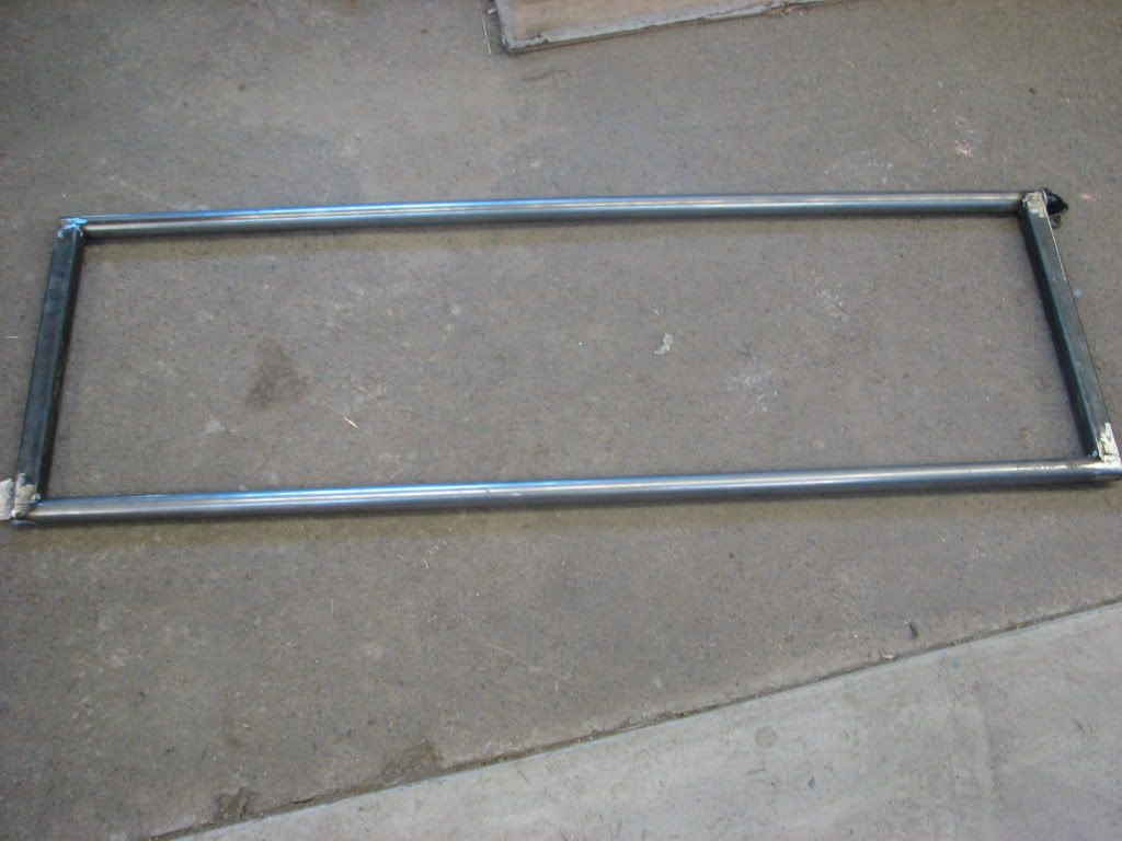

Decided to build myself a tailgate frame today.
Using some electrical conduit bushings to make the hinges a little smoother.

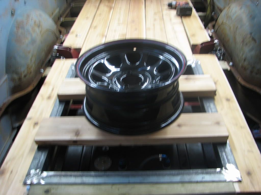

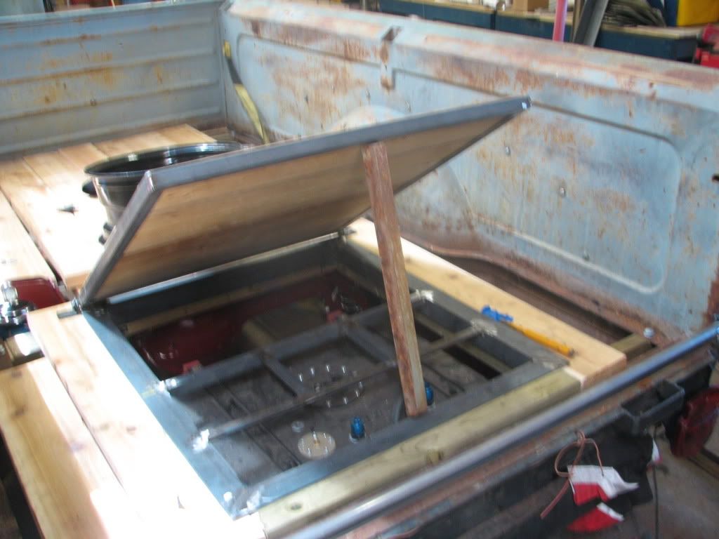

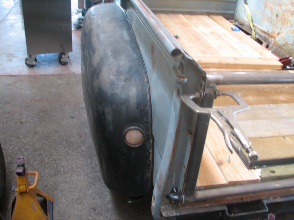

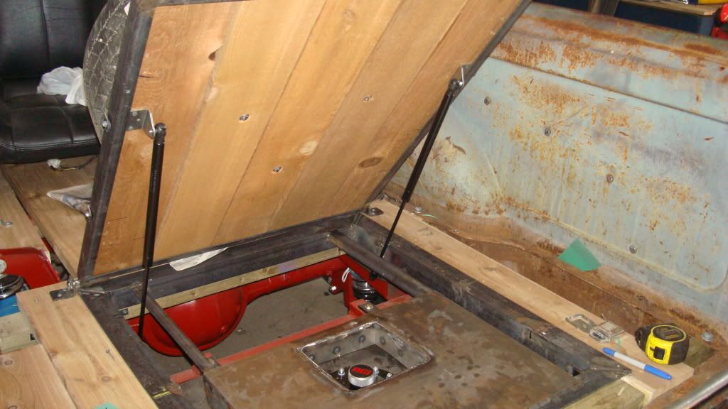

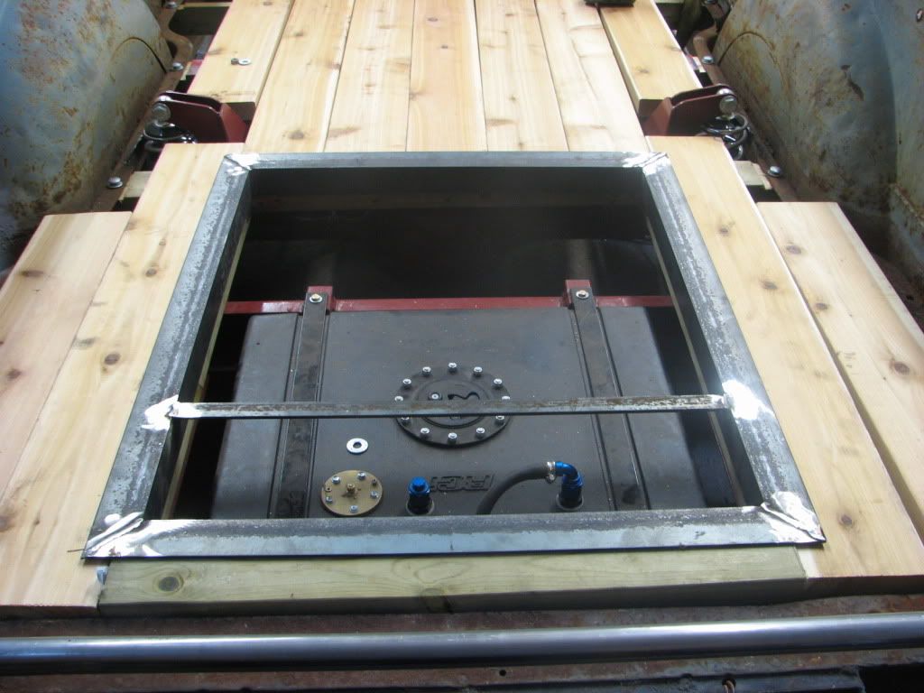

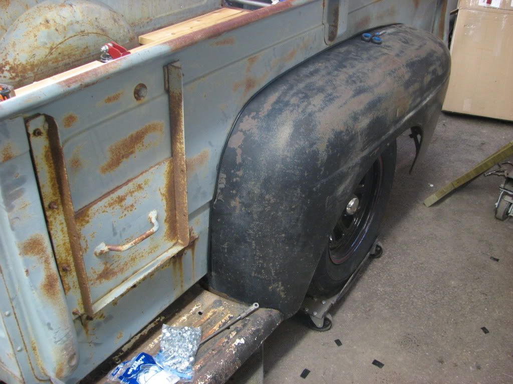

Started on the frame for the spare tire and gas cap access and refitting the rear fenders.
Old Aug 8, 2011 | 09:24 PM
  #36
Englishbob's Avatar
Englishbob
Joined: Jun 2011
Posts: 135
From: Calgary,AB

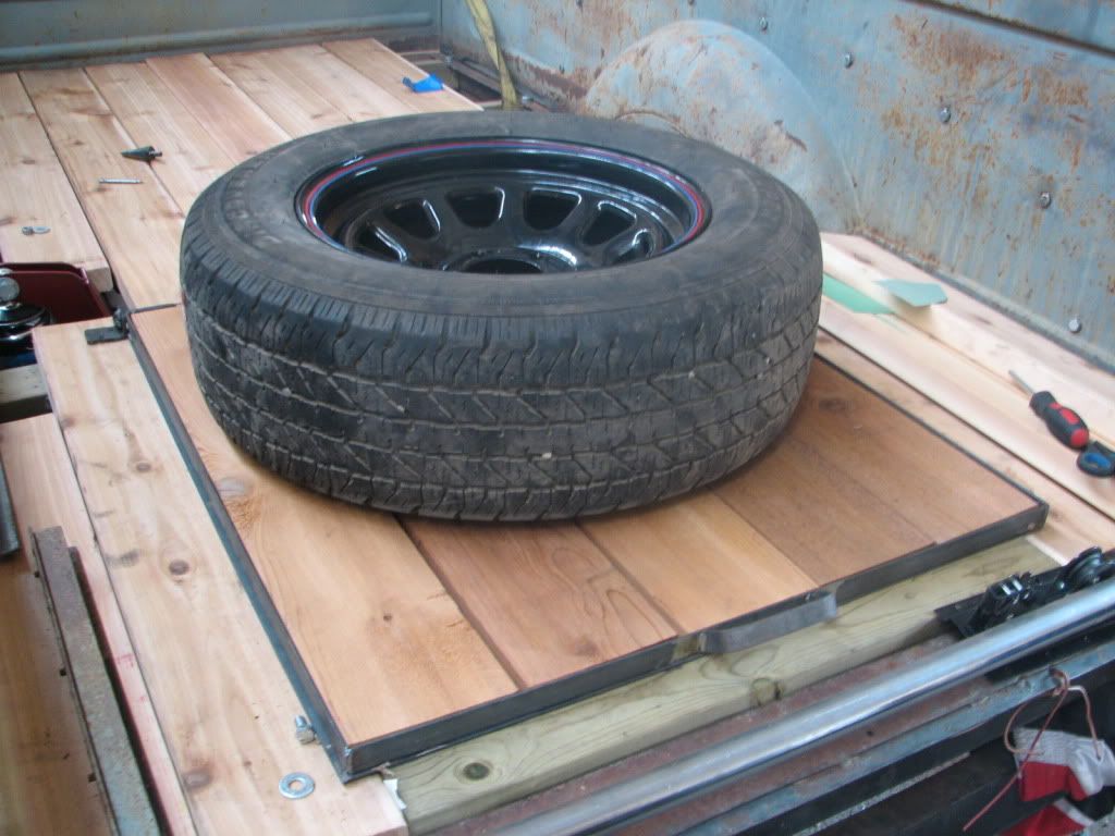

Had some later Ford taillights so I thought I'd use them.
Made a couple of spacers to mount them.
Got the rear fenders on and finished the spare carrier/gas filler hatch.

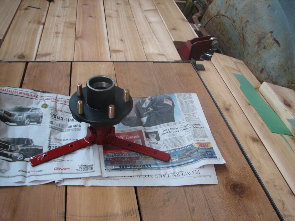

Got the gas springs mounted on the tire carrier.

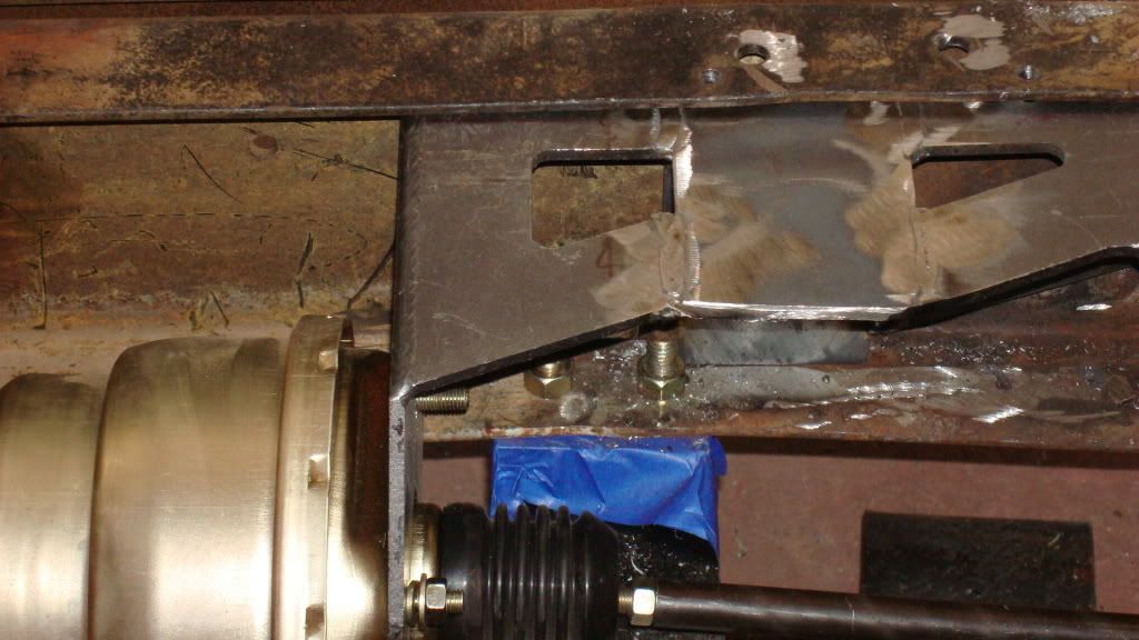

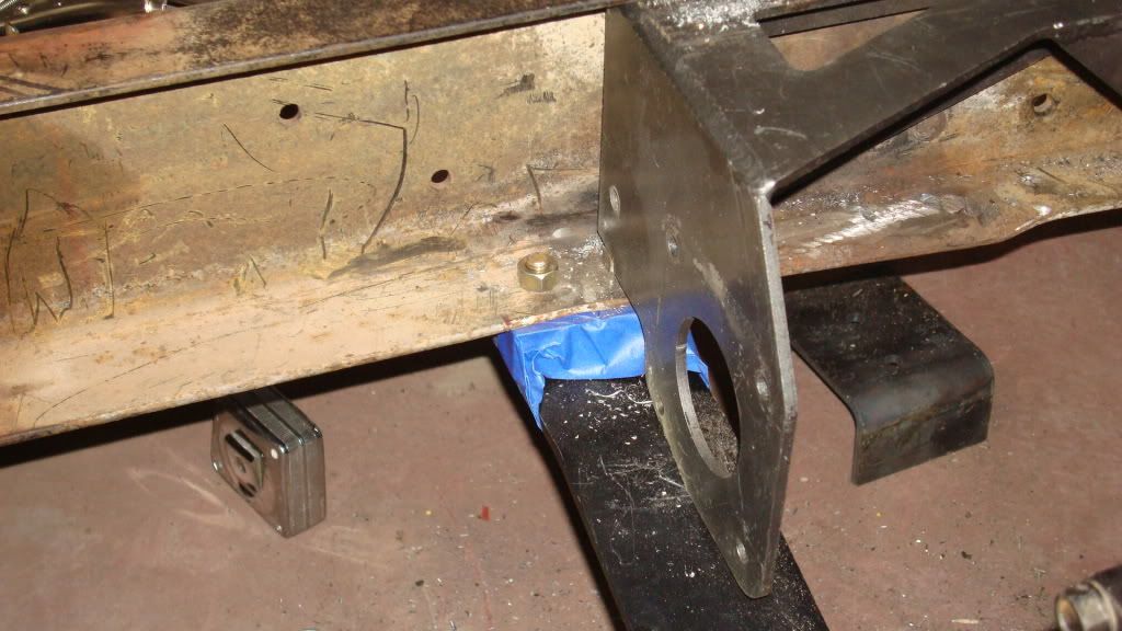

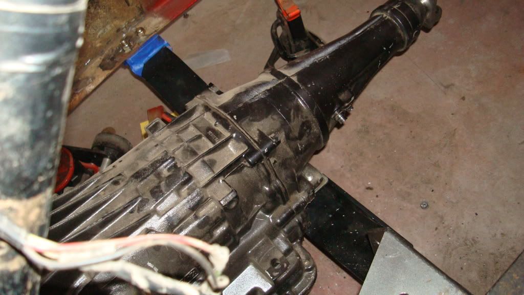

Finally got the trans x-member ,had to make 2 one inch spacer blocks and then got it fitted.
Mocked up the brake pedal/booster bracket.
Now comes the question...Do I need to weld another piece to the bracket to space it the 2" needed or would 4 x 2" pieces of threaded tube be strong enough?

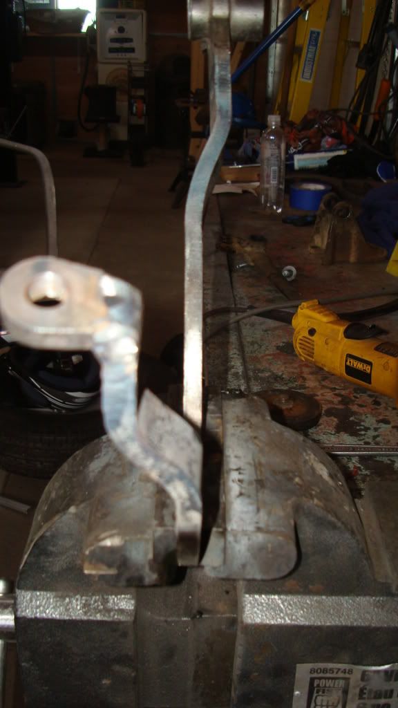

Bent the brake pedal to mirror the original.

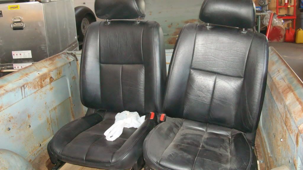

Picked up a nice clean pair of leather buckets for it.

Grafted a 3" piece of metal into the pedal/booster bracket so it clears the x member.
