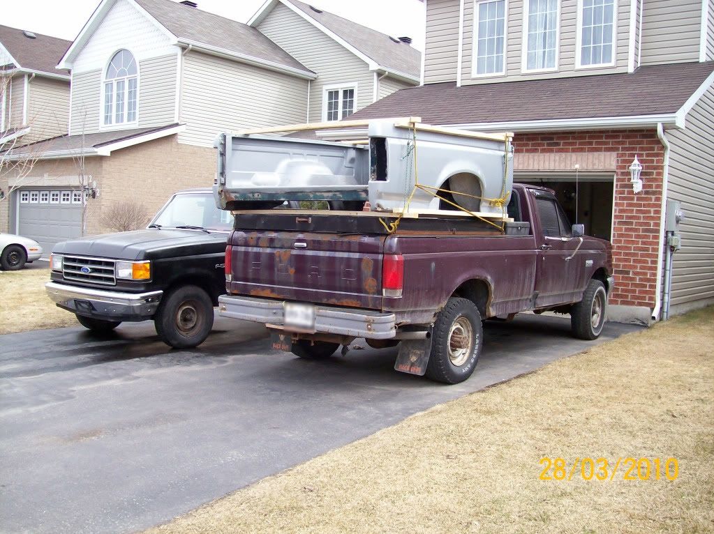

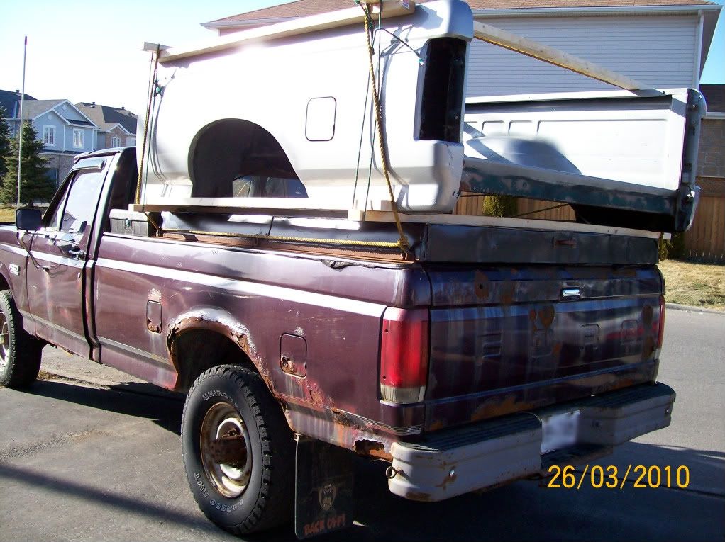

Heres how I did it.
Real simple.

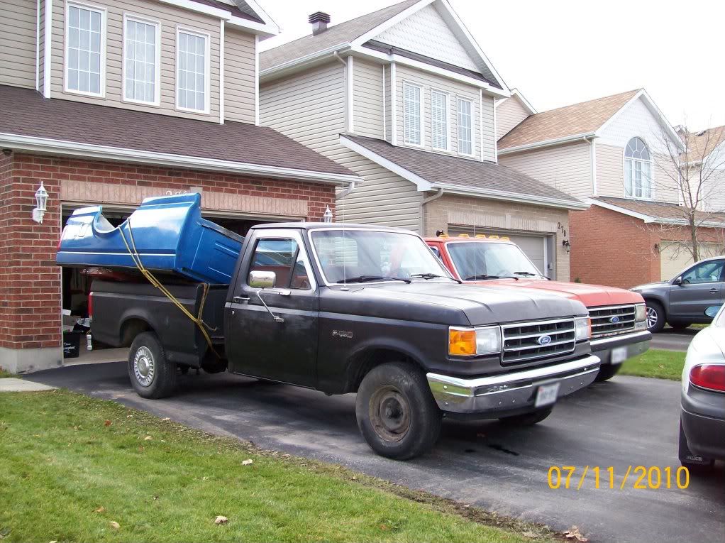

And this is how I did it the second time. That silver short box in the first pics, is now this flat black box, carrying a new box for the diesel
I wouldn't do it like this again though...
