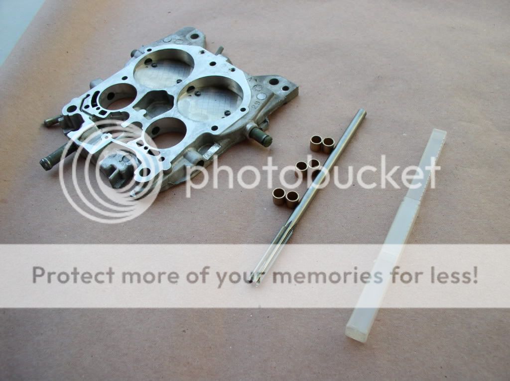

I contacted Cliff Ruggles, the author of the book, and he recommended the jets/m.rods for my engine. I also bought his kit, and will make the needed mods he suggested.
Anyway, here are some photos of my progress.
You have to love those toilet-flusher secondaries.
Here is the bushing kit I bought to repair/tighten/stop v. leak in the t.shaft. $45 on ebay. Interesting how the cutting side of the reamer goes into the drill bit, and you drill in reverse. The shaft is in the other t.shaft holes when you cut, so it is perfectly alligned.
Tapped the bushings into place with a stud and nut.
The next photo is the part that bothered me. I didn't want to do it, but when I read how it was the part that messed up more rebuilds than anything else, I did it. I had to heat the casing with a torch, and tap down the inside copper tube 1/8", then cut off the tip of a drywall screw, and screw it into the idle tube collar. Once in, I put a piece of aluminum on top of the housing for protection, and used a pair of wire cutters to pry the idle tubes from the casing. C. Ruggles included new ones with my kit. You can see one of tube to the left of the wire cutters.
