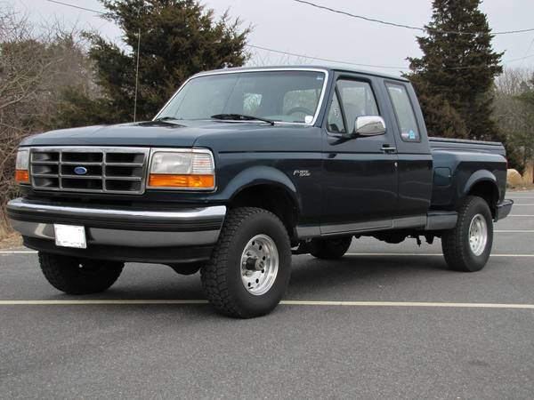

i have a 95 f150 supercab 4x4 with sportking at 32/11.50/15 and have no rub with everyday driving and im just running the stock alum wheels
