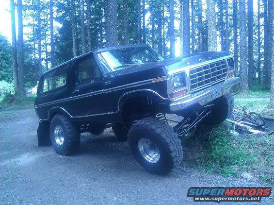

And a few pictures of my what started it all for me, my Dads rig

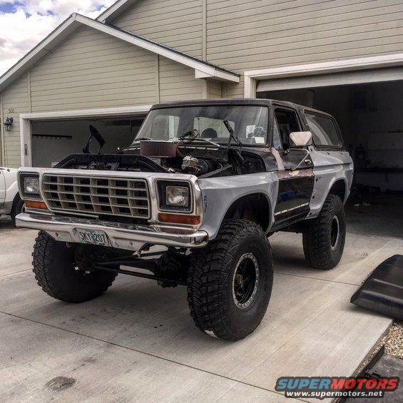

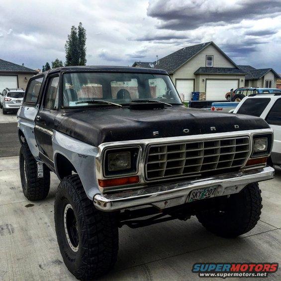

well I suppose I'm overdue for an update...
got the one ton swap finished up, and wheeled it for a little while before getting stationed overseas for a couple years.

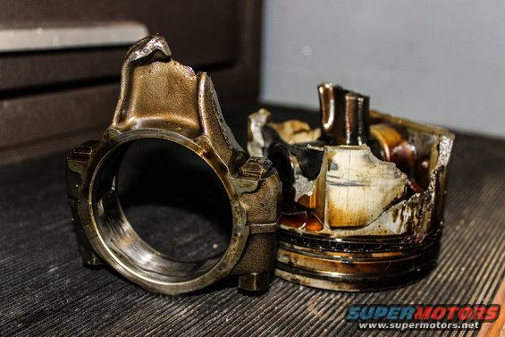

while I was home on leave the piston got in an argument with the piston rod, and they decided to part ways

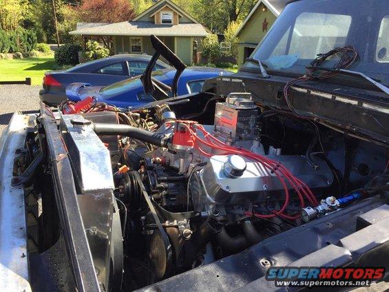

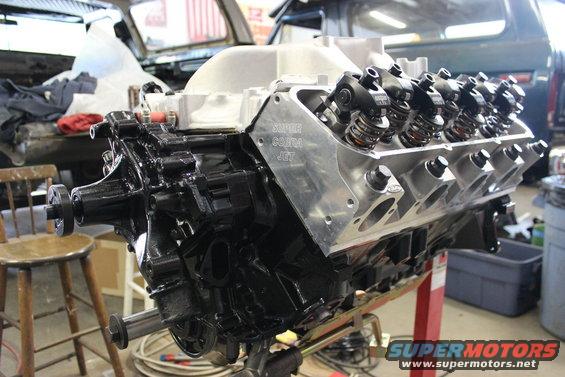

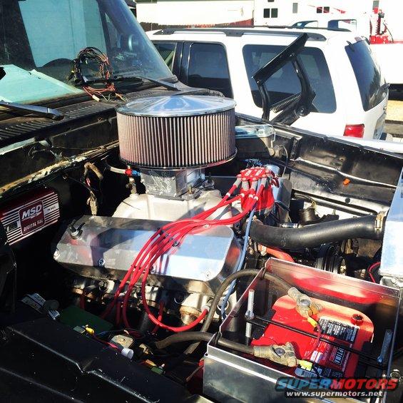

I recently got back stateside, with a pile of parts welcoming me. I assembled my new motor, a SCJ headed 545ci Stroker.
build specs:
-Lunati Voodoo forged 4340 crankshaft (4.5 stroke)
-Lunati Voodoo forged 4340 H-beam connecting rods with ARP 2000 bolts
-Diamond Racing forged pistons (.030 bore w/Cobra Jet valve reliefs)
-Diamond Racing file fit plasma moly rings
-King HP/XP bearings
-Ford Super Cobra Jet aluminum heads w/ bowl blending and port work
-Lunati roller rockers
-Lunati solid flat tappet cam/lifters
-High Flow Dynamics Street/Strip oil pump
-Weiand Stealth SCJ intake
-L&L 3/4 length headers
-Lunati 9-key billet timing set
-Full MSD igntion (pro-billet dizzy/6AL/coil/wires)
-11:1 compression

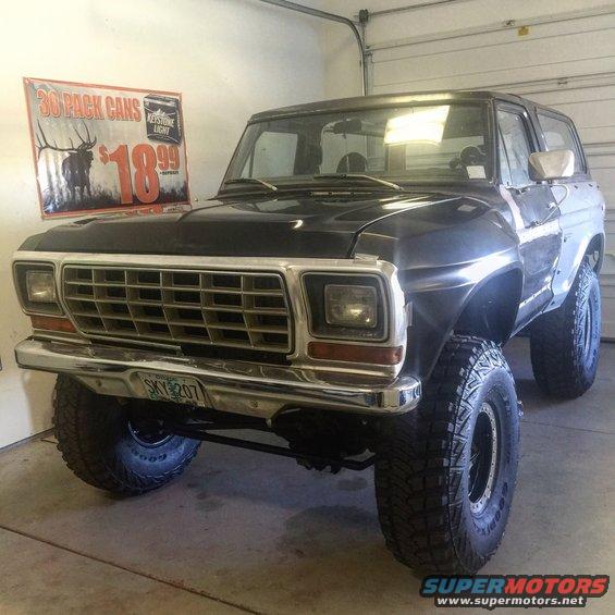

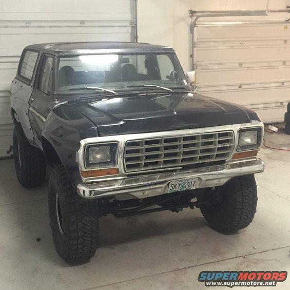

while building the motor I also installed Autofab Bulged fiberglass fenders. The Bronco has taken a turn and is now becoming a more "go-fast" prerunner oriented build. Also, its now on 40x13.5x17 MTR's and Walker Evans Beadlocks.
then McQueen Products contacted me about their new front end and I had to have it!

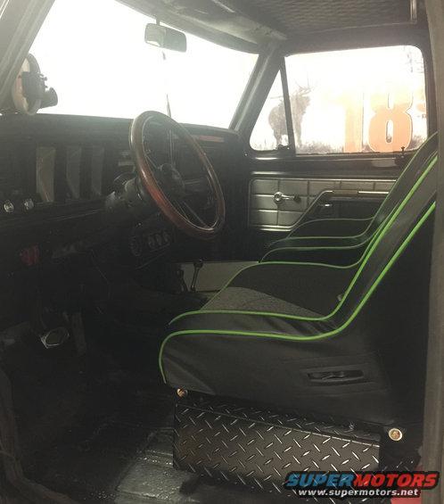

Oh! and I got some new butt holsters
And thats pretty much where it sits now. Ive had about a month or two of time to work on it in the last 4 years... I'm deployed currently but but i'll be stateside again soon and have big plans for it!
