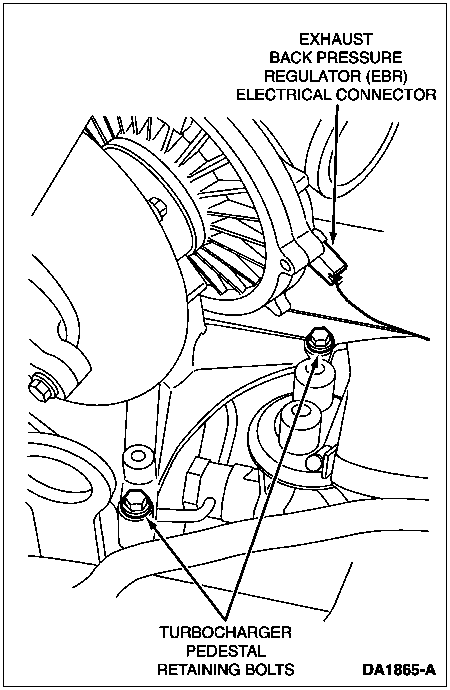

Originally Posted by seanlleiker
Is it easy to disconnect the EBPV.
Sean
Sean, take a look under the intake side of the turbo, there will be a connection there with a 2 wires. Disconnect that to disable the EBPV
Sean
