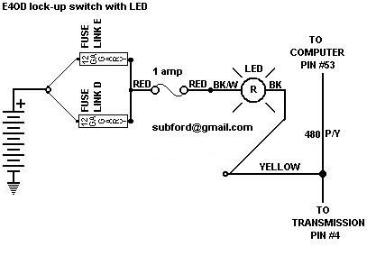

How would be the best way to wire a simple LED in the dash that with light up when the torque converter locks up on my E4OD?

This is the way I did it.
Note LED can get hot so mounted LED on hood release bracket.

Your awesome subford, Thanks a million. I didnt waqnt to hook it straight off the P/Y wire because the draw of the LED might keep the tranny from seeing the correct voltage needed for lockup.
I didnt want to hook up the "switch" just yet...Im undecided on whether or not thats a good idea, my tranny is already slipping in reverse. I would just like to "monitor" and see when the ECU decides it wanted to use lockup.
So, In my case, this would work? Also, is that a dual fused link for the LED?
No those are stock fuse links you already have.
The 1 Amp fuse is for the LED circuit.
The LED is powered from the battery and not the transmission. The computer grounds the P/Y wire to turn on the LED and to engage the clutch. You might check the voltage on the P/Y wire with the clutch engage from the computer and see if the voltage goes to near zero with the LED and without the LED. I would like to know this myself but have not had a chance to check it yet.
I would think if the transistor in the Computer can ground a solenoid then and added LED would not matter but I do not know for sure.
