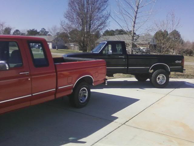

black single cab on p.454
https://www.ford-trucks.com/forums/6...l#post10028185
i will take some better pics today though.. i personally love the look. the only reason im running 12.50 wide is cause i got them for free. when they wear i will go wider

more pics anyone like??
headlights will be here sometime this week...
