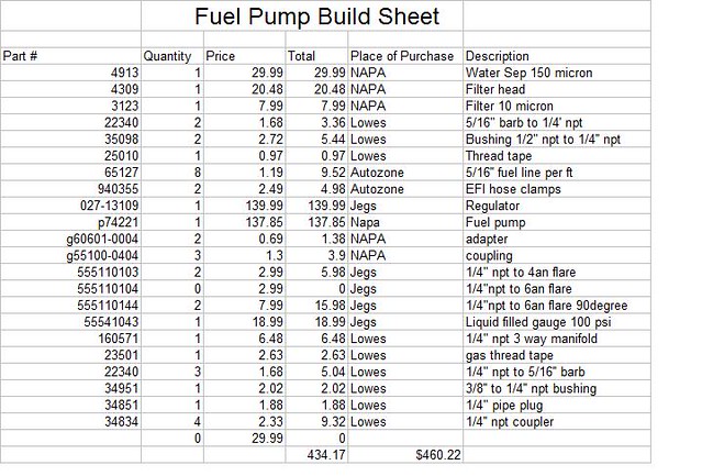

I have an Aeromotive. Came from jegs.
Heres all the part numbers I used.

hmmm and you can use both your stock tanks??? do you have any more on this or any picks???460 is not bad at all from some systems i have seen. would like more info if you got it, dose it run better after??
