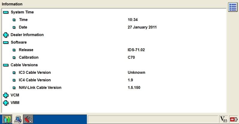

Thought I would hook up my VCM this morning and see if anything new was happening. First the download manager upgraded my IDS software (v. 71.02) and VCM firmware to the newest versions:

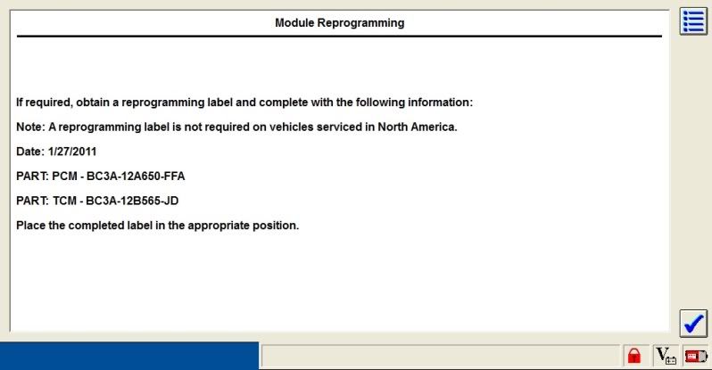

Then I checked for new flash updates - nothing new on the ABS, APIM, or IPC modules - but when I checked out the PCM, I got this:
Hhmm, I can't find out what exactly this flash is for - I know it is not the 400/800 flash since I had that done already. I can't find any service alerts or docs specifying what this is for - I suspect it may be related to TSB 10-23-9 although my vehicle does not exhibit any of those issues nor has it thrown any of the DTC's identified in that TSB. However there are no other TSB's that specify TCM and PCM reprogramming for vehicles built before 11/5/2010 so it has got to be this. My truck is Job1 built in May 2010 and I had the 400/800 flash completed in Aug 2010.
In any case, I did the flash and it went smoothly - it takes about 20 minutes start to finish to update both the PCM and TCM. Since those modules were updated the truck now needs to go through a learn period again to montior shift points, etc. I will report back if I notice anything significantly different from the pre-flash.
Here is the new flash confirmed. I think dealers ought to provide this screenshot/printout to customers as evidence:
