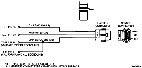

Looking here for a wiring schematic that shows than main harness system. I am trying to solve an IVS issue and might just re-run two new wires direct from the PCM to the IVS. Is there one available or did I miss something? Thanks!
Old Oct 10, 2013 | 08:16 PM
  #69
strokin'_tatsch's Avatar
strokin'_tatsch
Joined: Jun 2007
Posts: 10,008
From: Austin, TX
I haven't seen anything like that in this thread. I'm not sure I've ever seen a schematic for the IVS. lol
Old Oct 10, 2013 | 09:09 PM
  #70
BBslider001's Avatar
BBslider001
Joined: Mar 2012
Posts: 10,590
Likes: 382
From: Texas
What about one that just shows the connections to the PCM? I know the wires are color coded, but with the age of the vehicle, sometimes the colors are hard to tell. Like, is that a pink stripe on the red wire or an orange stripe? LOL
I would just need to be able to see which pins are what.
Old Oct 10, 2013 | 09:14 PM
  #71
fordpride's Avatar
fordpride
Joined: Dec 2009
Posts: 15,505
Likes: 18
From: Livoina,La
Old Oct 10, 2013 | 09:16 PM
  #72
fordpride's Avatar
fordpride
Joined: Dec 2009
Posts: 15,505
Likes: 18
From: Livoina,La
Old Oct 10, 2013 | 10:57 PM
  #73
BBslider001
Joined: Mar 2012
Posts: 10,590
Likes: 382
From: Texas
Mike!! AS we say in Southern CA, you rule SUPER hard!! Thanks so much for this. I can't do anything until the morning, but I feel like this will be a huge step towards getting the problem worked out. A couple of other guys gave me some invaluable info as well. I am getting more confident I will get this licked! Thanks again!
