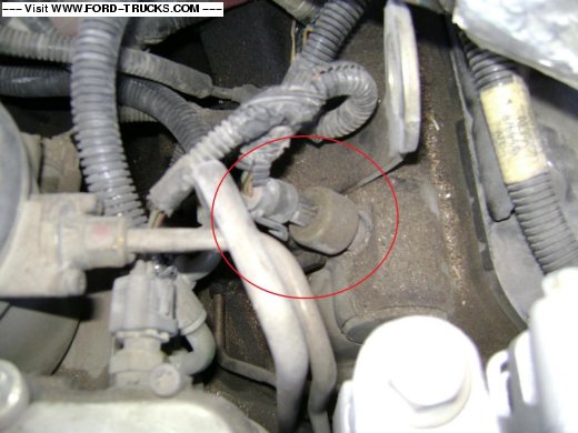

On the driver side head there is a sensor ,3 wire , right next to the lifting ring . Unplug it & try to start it ...
Also . On the front of the motor there is a rectangular shaped oil reservoir . take out the small plug & see if it is full of oil

OK I did everything
I checked fuse 22 looks good to me. My fuse box is missing for the record. Relay 1, fuse 21 and 19 I dont know if Im suppose to have them.
I also unpluged the 3 prong plug you mentioned and tried to start it no luck.
I just figured out what the oil bath is your talking about. I knowticed you pointed out tow plugs. Which do I open the little metal plug? I dont know how I would see in there sorry I may be dense? At what point on the block do I open to check for oil? Thanks again I hope to get it started this weekend Im going crazy and its blocking in my skid steer which means snow back up for me.

The hex or torx plug is where you check the oil . stick a screw driver in there as a dipstick....

The plug that you recomend I pull is stripped on the inside. It was that way I didn not even attempt to open it. I see what you needed to open it but somebody before me must have tried to use a screwdriver and now its trashed. Iim going to have to easy out it, and cant right now.

Pull the oil sensor to check the level for now , the noise you heard is most likely the fuel heater

Ok Thanks again everybody. I opened up the left side plug where the sensor plugs in with a big wrench. The one Rick mentioned. I put a screw driver down there as a dip stick. There was a tiny tiny bit of oil and I touched the bottom. So little oil that the small thin philips head I put down there didnt even have oil to the top of fthe tip. It was just like a couple drops. I dont know what this meants or if I have to fill it?

fill it about 1/4 inch from the top and try to start. it may be leaking down

it is either leaking down or the low pressure pump is not filling it. i think there is a check valve that goes bad or something like that
